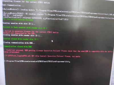

I got an error when downloading the .sfi file to STM32H753II using the STM32Programmer_CLI, my HSM version is V2AE.The error message is as follows:
What its mean?V2AE cannot support STM32H753,and must use HSM_V1?or H753 cannot support SFI ?
I’m a new use about SFI.Looking forward to your reply.

Hello @SONGTAOSI ,
SFI is supported on H753 with HSMV2.
I cannot read your screen capture.
You have a X-CUBE-SFI on st.com providing an example of different steps to follow.
Best regards
