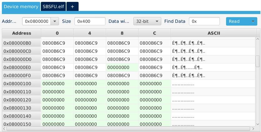

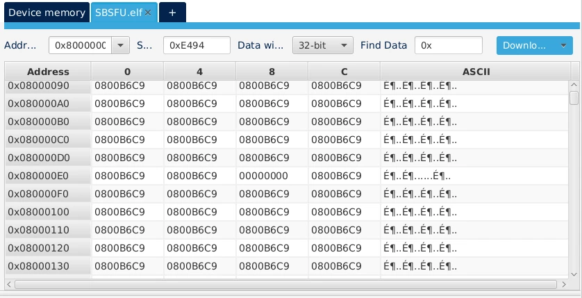

H753ZI board unaccessible after download of incomplete secure boot
I want to integrate a secure boot and secure software update (SBSFU) on a nucleo H753ZI board.
I downloaded the software from https://www.st.com/en/embedded-software/x-cube-sbsfu.html and followed the steps to compile the three programs (SECore, SBSFU and UserApp) proposed in the "projects" folder using the 1-image version of the SBSFU.
The next step was to program the SBSFU application on the board which I tried to do using STM32CubeProgrammer. However, the program has not been completely installed. The first image below shows the device memory after the introduction of the application and the second image shows what should have been programmed. You can observe that the code abruptly stops after the address 0x08000100 while it should continue.0693W00000APJdCQAX.png0693W00000APJd7QAH.png
I suspect that something went wrong when I prepared the board and that the region after 0x08000100 has been mistakenly let as an area protected against writing.
My problem is that since this incomplete code has been inserted inside the board, I can not access it in normal mode using STM32CubeProgrammer, I get a  DEV_TARGET_NOT_HALTED error. The only way I can connect to the board is through hot plug mode. But from there I am unable to change any configuration, erase the memory or program anything else on the board.
Is there any way to somehow reset the board, or force it to clean anything that has been programmed on it to put it out from its idle and non-available state?

EBonv
EBonvAuthor
May 24, 2021 10:54 AM UTC
As stated in the original question, my problem is that I can not access the board anymore in a mode other than hot plug mode as the board never halts.
Unfortunately, in this mode I do not seem to be able to clear the protections using STM32CubeProgrammer and I am unable to program anything else on the board. Using the debugger does not help either.
This is enthusiastic and trusting. My post describes cautious steps. I've only developed custom boards. I can imagine if software purports to exactly support your dev board you may expect it to work. Even so, X-CUBE-SBSFU is example code.
The terms program, install and application may be ambiguous. Anything I say is guessing. Maybe something here will help.
X-CUBE-SBSFU uses the term "install" to describe the decrypting and writing the application into slot#0; the active region. But your first image is of STM32CubeProgrammer with the SBSFU.elf loaded. That's the boot code and not the application. So you've programmed only the SBSFU.elf to flash?
STM32CubeProgrammer would completely program the SBSFU.elf to flash, else it should have thrown an error, or the SBSFU.elf is incomplete and was programmed successfully. Perhaps inspect your link map file or elf file to ascertain if the SBSFU is good/complete. If you didn't output a map file, you might use "objdump.exe -t SBSFU.elf". Look for the addresses and sizes of each of the protections. You will find their symbol names in the code.
