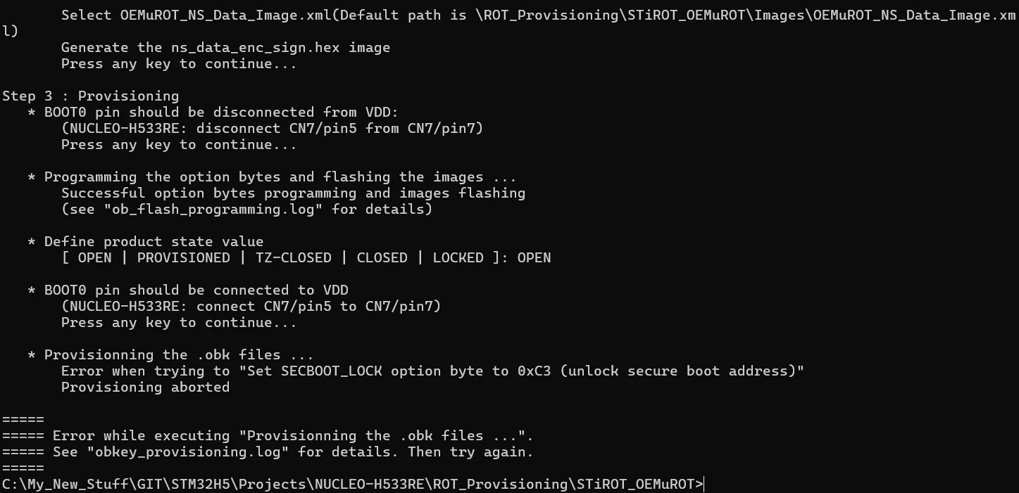

Getting Error when trying to set OPEN Product state in STiROT_OEMuROT example
Unable to set the Product state to OPEN using the Provisioning script in the STiROT_OEMuROT example.
Getting the below error:
But,when i’m trying to set the Product state as CLOSED it is getting Success.
Note: Ensured to connect the CN7/pin5 to CN7/pin7.
Also,Below is the obkey_provisioning.log content:

OPTION BYTE PROGRAMMING VERIFICATION:
Error: Expected value for Option Byte "secboot_lock": 0xC3, found: 0x0
Error: Option Byte Programming failed Or modified by application after OB_LAUNCH
Time elapsed during option Bytes configuration: 00:00:01.372
Please suggest how to resolve this issue.

Jocelyn RICARD
Sep 10, 2026 1:34 PM UTC
Hello ​@Shaik Akheel ,
I’m not able to reproduce your issue.
It looks like there is a kind of mixup in your tools: The trace you have corresponds to the first step of programming that requires that BOOT0 is disconnected form VDD.
Could you please check with the original version from the cube ?
Best regards
