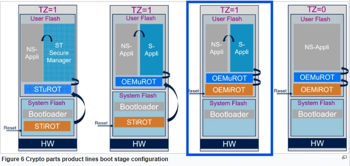

I am working and trying to boot Nucleo - STM32H533RE board. I could successfully boot board using one stage bootloader OEMiROT, but I want to board to boot board with two stage boot path that to to without using STiROT.
Looking at wiki page, I could see this can be achieved on Nucleo board I have, but there is no working example in the latest STM32Cube_FW_H5_V1.6.0 package I have.
I could see boot path example for STiROT + OEMuROT example but no example for OEMiROT + OEMuROT.
I need to know whether I can achieve booting of Nucleo STM32H533 board with desired boot path i.e. OEMiROT + OEMuROT (as encircled with blue color) and if yes is there any support with relevant data available?

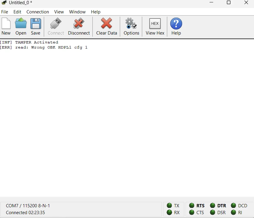

I have tried creating OEMiROT + OEMuROT provisioning package but I am getting wrong HDPL1 cfg error when booting-

Now HDPL1 Cfg is resolved and all validation completed successfully at OEMiROT stage but unable to see control jumping to OMEuROT.
Any idea?
