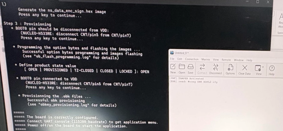

Error while running the STiROT+OEMuROT example on stm32H533 Nucleo board
I am using the Nucleo STM32H533RE board for booting with the two stage boot path for which I am using the ST template code and referring the following   https://wiki.st.com/stm32mcu/wiki/Security:OEMiRoT_OEMuRoT_for_STM32H7S .
I am able to run the provisioning script successfully but when I am connecting the serial terminal to verify the serial data sent out by the board, I am getting an error saying “[ERR] read:Wrong OBK HDPL2 cfg” as seen in below image:
I tried with the following things:
  1. Regenerating the OEMuROT OBK files manually using stm32 trusted package creator
  2. Running the regression script to erase the flash and again running the provisioning script
  3. Verified if the key file names matches the script references
Can someone help me with this issue.
Let me know if any other details are required.
Thanks,
Amruta

Jocelyn RICARD
Jocelyn RICARDBest answer
Jul 7, 2026 17:22 UTC
Hello ​@Amruta D ,
Ok I could reproduce your issue probably doing the same mistake as you did :)
The point is that when provisioning in open state, you will connect the CN7 pins to set BOOT0 to VDD to provision the obk.
What you probably did (like me) is to remove the jumper and reset.
When staying in open state, you actually need to keep BOOT0 tied to VDD.
As BOOT_UBE is set to 0xC3 (STiROT), in order to boot on STiROT and not on OEMuROT you must boot on system flash.
If you boot in user flash, you will boot in HDPL1. So, when reading HDPL2  OBK you will read only zeros (this is what I noticed when debugging). This explains the error.
If after provisioning you leave the jumper in place it will boot properly
Best regards
Jocelyn

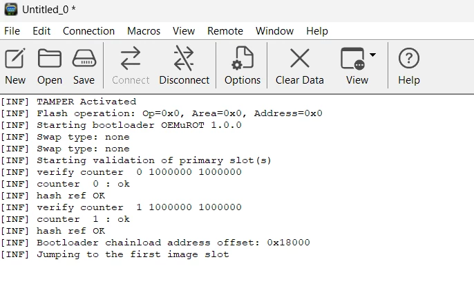

Amruta DAuthor
Jul 8, 2026 08:38 UTC
Hello ​@Jocelyn RICARD ,
You are right, I was removing the jumper and disconnecting the connection of BOOT0 pin with Vdd
after provisioning was done successfully due to which wrong HDPL2 OBK was read.
When I am leaving the jumper as it is, I am able to boot the board correctly and getting the correct
serial data out from the board as seen below:
Thank you so much for helping.
Regards
Amruta
