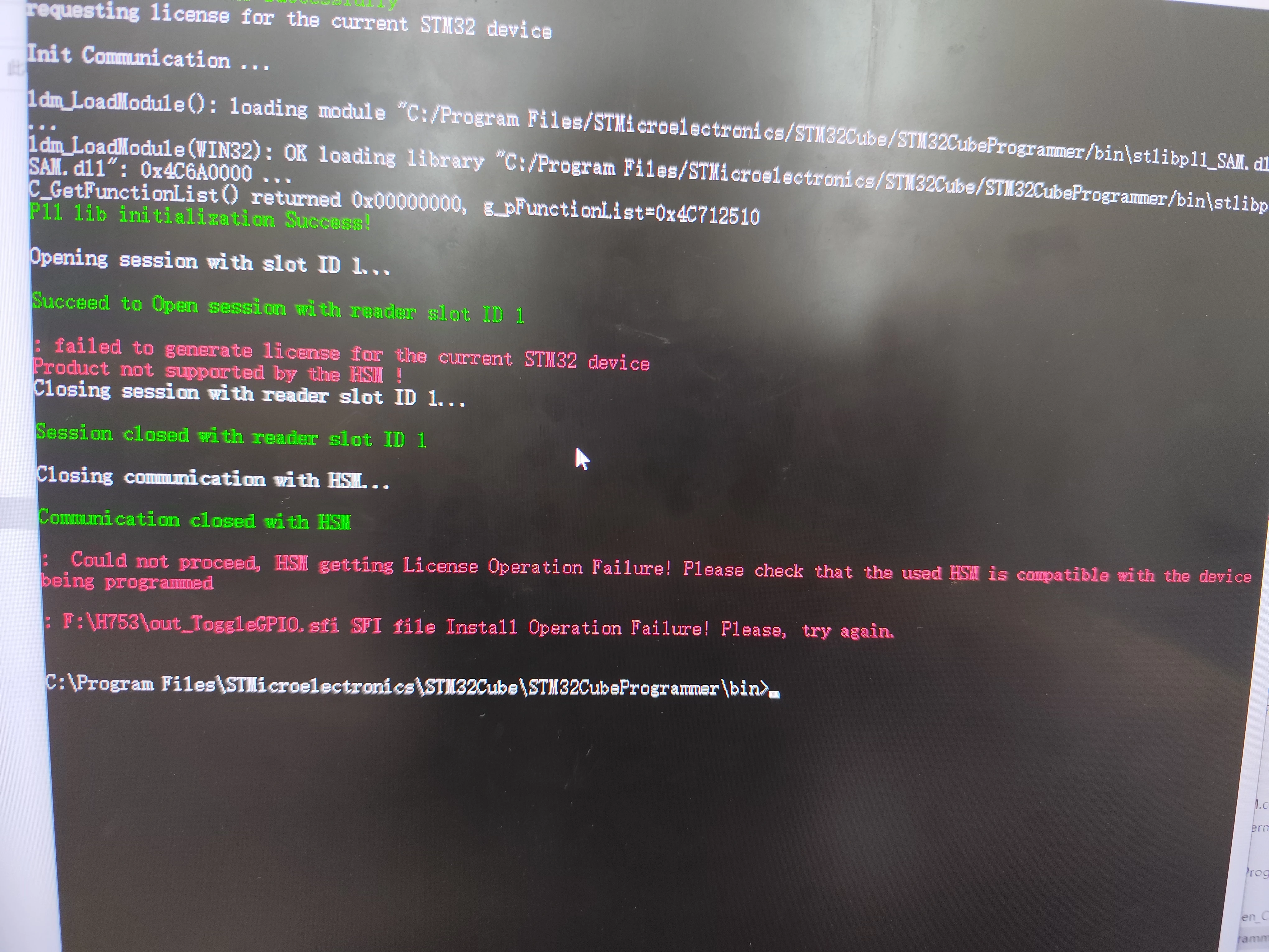

I got an error when downloading the .sfi file to STM32H753II using the STM32Programmer_CLI, my HSM version is V2AE.The error message is as follows:
What its mean?V2AE cannot support STM32H753,and must use HSM_V1?or H753 cannot support SFI ?
I’m a new use about SFI.Looking forward to your reply.

Hello @SONGTAOSI ,
The HSM V1 is deprecated. All devices supporting SFI are using HSM V2.
Please try the example provided in the X-CUBE-SFI
Best regards
