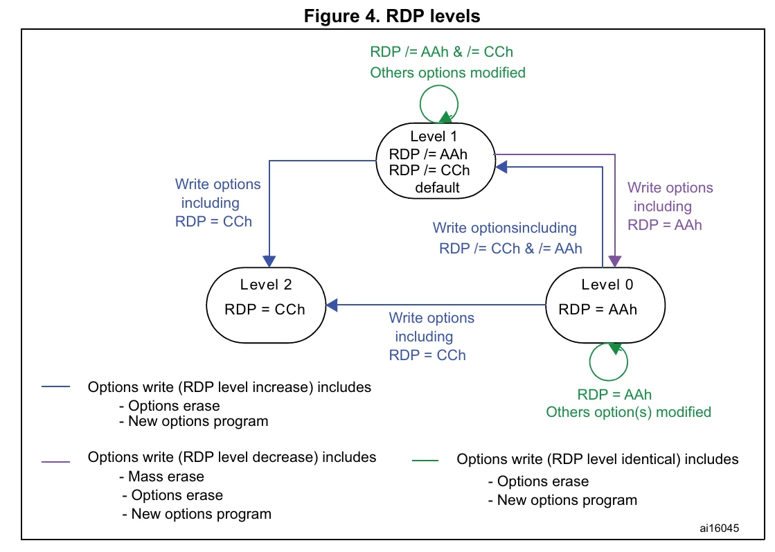

Need help? Is it possible to disable RDP2 and return to AA mode when I did not set a password before setting up RDP2? Is there a default STM password?
Thanks

Setting RDP2 on the STM32F7 is irreversible. There is no password relevant to this operation.
