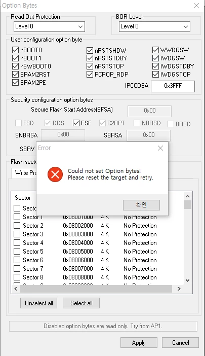

I had a problem while uploading firmware into my custom board.

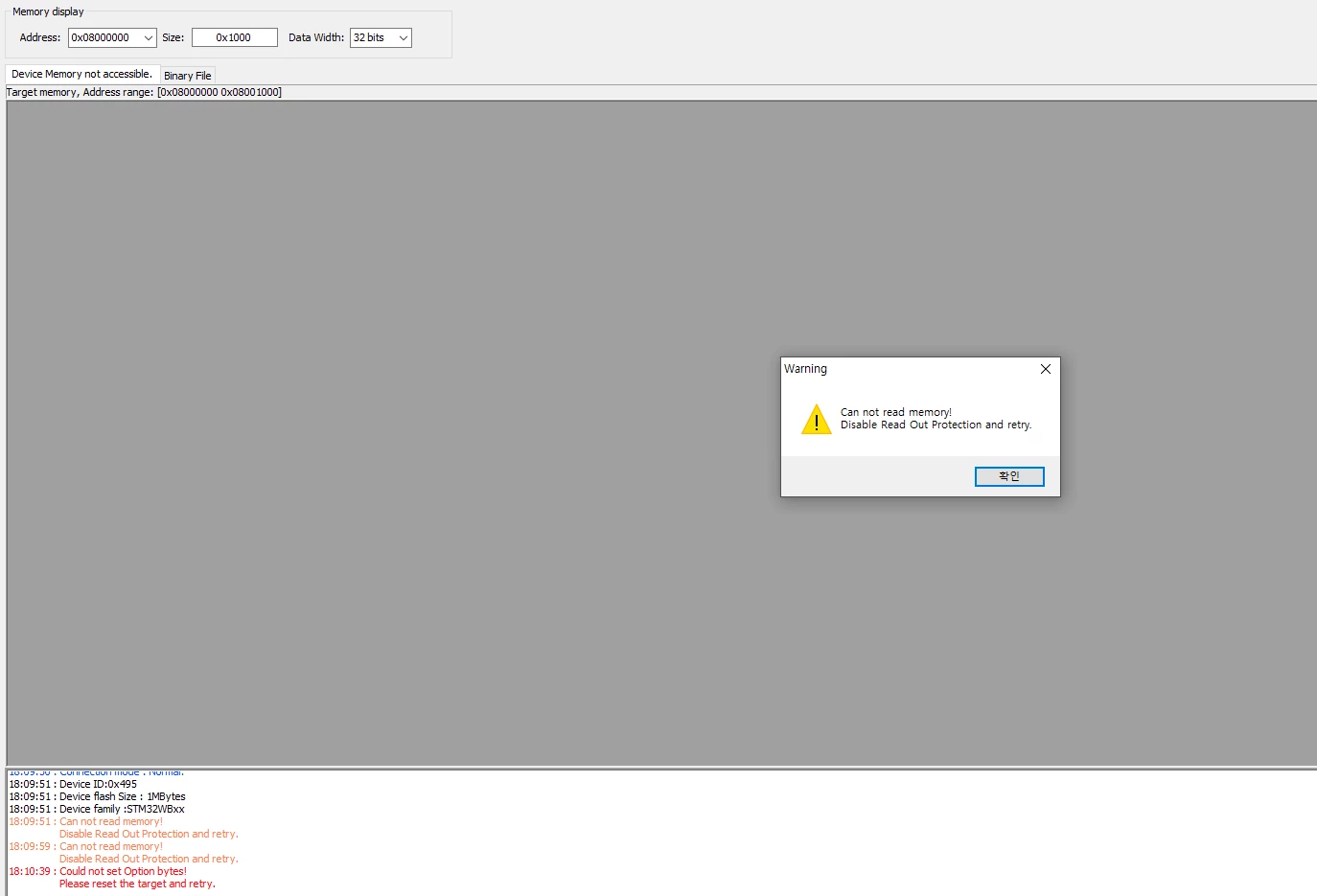

I used ST-Link attached at NUCLEO-F091RC board, and I could read Option Bytes and Memory at 0x00000000 using ST-Link Utility and STM32CubeProgrammer.
But I can't read or erase flash memory.
It notifies "Can not read memory! Disable Read Out Protection and retry."
and when I try to change Option bytes, notifies "Could not set Option bytes! Please reset the target and retry."
and this is the log when I tried to download and debug with STM32CubeIDE.​

​This is the default option bytes.
I think the problem is RDP isn't Level 0.
How can I upload firmware to my custom board or disable RDP?
Thank you.

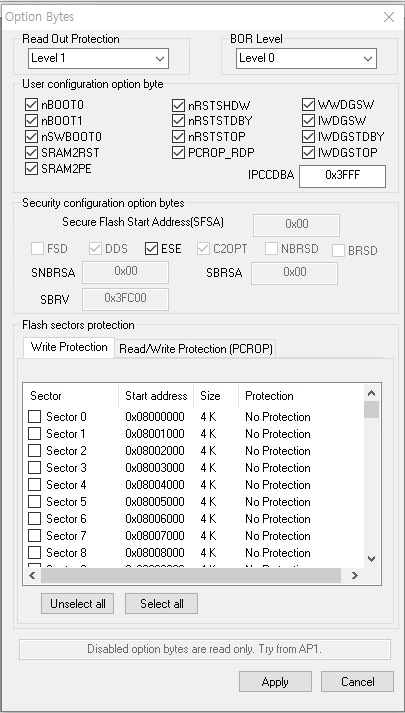

Hello @Remi QUINTIN​ , I have the same issue. The board seems blocked even if RDP is set to 0xAA. SFSA option byte is 0x00 as in @안 재우​ 's case.
I have tried to write 0x00008000 at address 0x5800040C but the operation is not working (photo attached). Is there any other possible solution?
Remi QUINTIN
June 14, 2021
I dont see any error in your log. Did you reset the board after this write access?
Could you download the option bytes ?
azzurri
June 14, 2021
Hi @Remi QUINTIN​ Thank you for your answer. Okay, I thought that I should read 0x00008000 after the write operation.
Yes, I can read the obtion bytes (photo attached).
Remi QUINTIN
June 14, 2021
Strange that the SBRV value remains pointing on the last sector of the Flash memory. I expected it to be pointing on the FUS at sector 0x3D000 with SFA = 0xF4.
