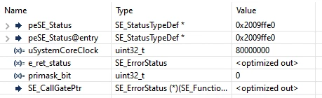

Can you provide the value, as reported by the debugger, of SE_CallGatePtr before that line is executed? I would expect it to be somewhere in system flash starting at 0x08000000.

So the value of SE_CallGatePtr is <optimized out> when I stop program before that line is executed (by breakpoint).
As for protections, I can see from Option Bytes read through STM32CubeProgrammer that Read Out Protection is AA: Level 0. Also PCROP and Write Protection in Bank 1 are also disabled. These have to be disabled anyway to reprogram/flash device and debug. For firewall specifically I don't see anything in Option Bytes > User Configuration or anywhere else.
For the SE_CallGatePtr being optimized out - could that be an issue? however why does the example project work for the STM32L476G-DISCO board without any issues? As I said I only modified few things and am testing on the STM32L4R9I-DISCO.
