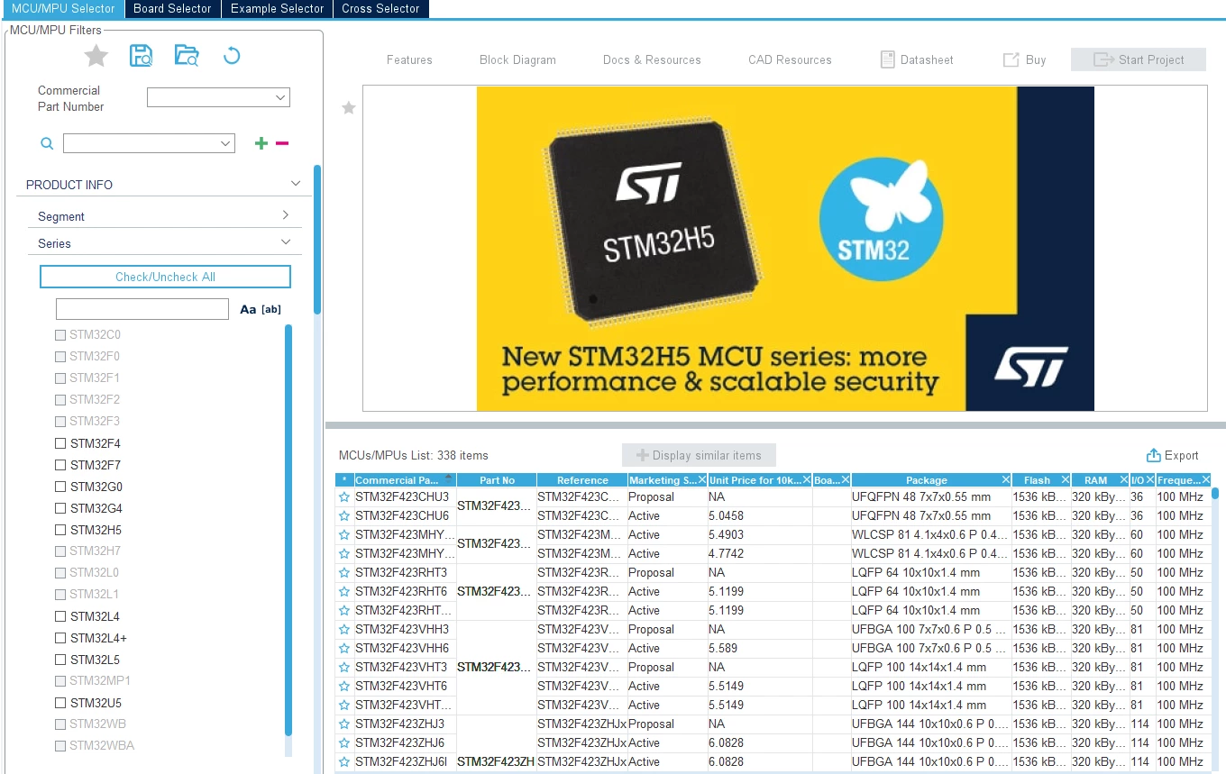

Hello @Nverm.1 ,
You can use STM32CubeMX MCU selector to narrow down your search according to you preferences, a quick search according to your specifications gave the following MCU series. To further narrow your search you need to provide more details.
BR
Hichem
