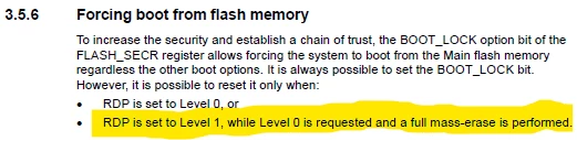

FArdi.1
Jan 25, 2024 5:53 AM UTC
I found this thread by searching. Is there any way to recover the board?
I wrote BOOT_LOCK and RDP level1 at same time. Now I'm unable to connect to nucleo board.
RM doc mentioned that it's possible to reset it back. But now I can't even connect to it using STM32CubeProgrammer.

Simon.T
Jan 25, 2024 8:14 AM UTC
To lose debug capability when the RDP level 1 is set in association of BOOT_LOCK is the normal behavior.
This behavior is described in the FLASH security register (FLASH_SECR) page 78 via a caution note:
After setting RDP level 1 and boot lock, re-enabling of debug capabilities is possible only by setting the DBG_SWEN bit by the application code.
Best regards,
Simon
FArdi.1
Jan 25, 2024 8:36 AM UTC
This means my boards are unrecoverable because I never prepare to access DBG_SWEN register in my application.
I'm expecting this information to be mentioned near the BOOT_LOCK .
My understanding of "debug capability disable" was unable to debug during runtime, but should always be able to connect under reset. But that's not the case.
