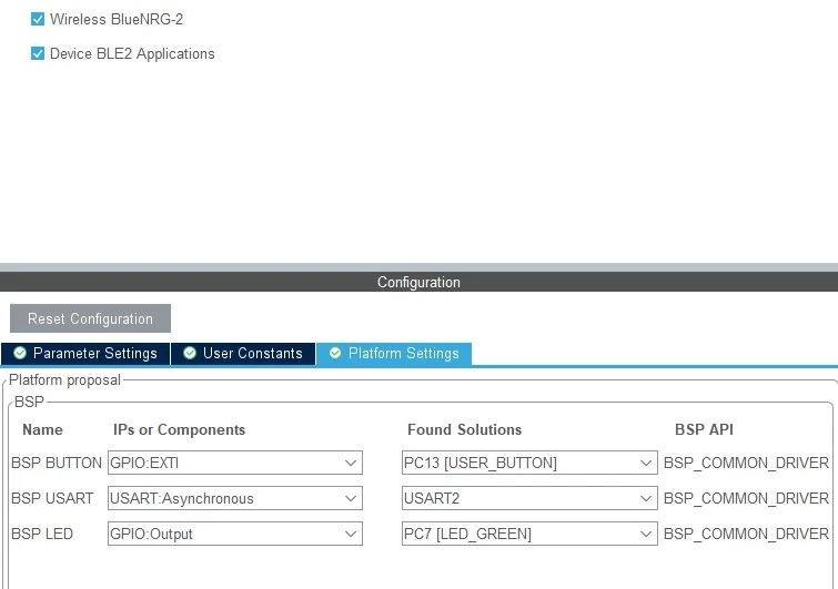

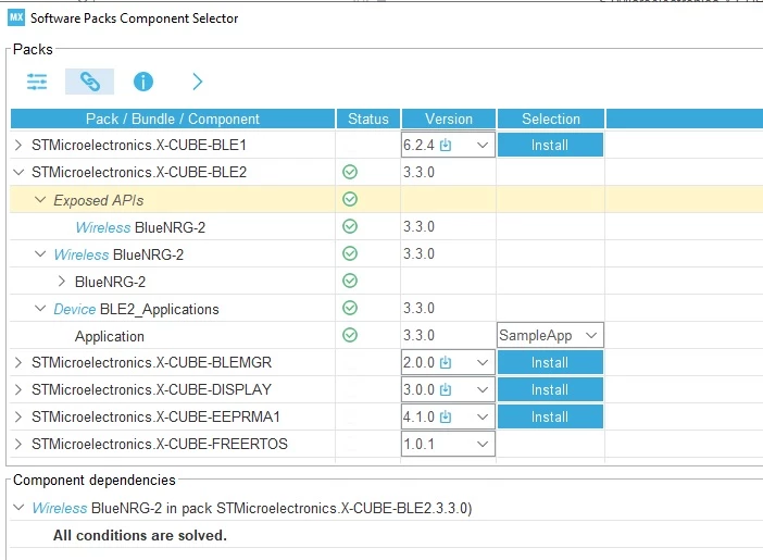

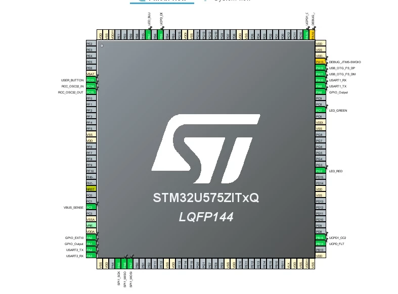

I picked up a X-NUCLEO-BNRG2A1, and I am trying to communicate with it through a Nucleo-U575 Board. I basically generated a project template through CubeMX for the STM32U575 and included the BlueNRG-2 (X-CUBE-BLE2) Pack to include Bluetooth HCL/ACI APIs along with the project template. These are some images from cubeide. The project doesn't work...when the flow enters in MX_BlueNRG_2_Init,  hci_send_req function
returns BLE_STATUS_TIMEOUT. D7 pin and the pin #5 of the J12 on the X-NUCLEOBNRG2A1
expansion board are bridged. Is there something else to do in order to make all works together?thank you

It could be required to bridge D13 and D3 pins to set correctly SPI SCK.

Also with D3 and D13 connected, hci_send_req function returns BLE_STATUS_TIMEOUT.
