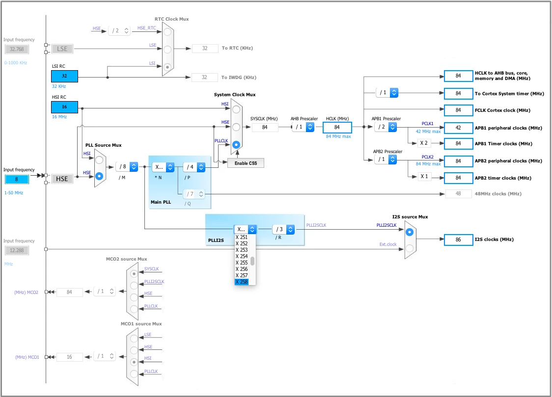

Hi, I have a nucleo f401re board and a x-nucleo-cca01m1 shield mounting STA350BW IC. Nucleo transmits data as a master to the shield using I2S half duplex communication. I want to know what is Master Clock's purpose on I2S bus. I understand that it stands for an external clock for STA350BW, doesn't it? So does the IC work on this clock?
In particular I want to understand the meaning of these settings referred to the master clock:
if (AudioFreq == 96000)
{ rccclkinit.PLLI2S.PLLI2SN = 344; rccclkinit.PLLI2S.PLLI2SR = 2; HAL_RCCEx_PeriphCLKConfig(&rccclkinit); } else if (AudioFreq == 48000) { rccclkinit.PLLI2S.PLLI2SN = 258; rccclkinit.PLLI2S.PLLI2SR = 3; HAL_RCCEx_PeriphCLKConfig(&rccclkinit); } else if (AudioFreq == 44100) { rccclkinit.PLLI2S.PLLI2SN = 271; rccclkinit.PLLI2S.PLLI2SR = 2; HAL_RCCEx_PeriphCLKConfig(&rccclkinit); } else if (AudioFreq == 32000) { rccclkinit.PLLI2S.PLLI2SN = 213; rccclkinit.PLLI2S.PLLI2SR = 2; HAL_RCCEx_PeriphCLKConfig(&rccclkinit); }(x_nucleo_cca01m1_audio_f4.c)
Thanks for any answers. Best regards.
