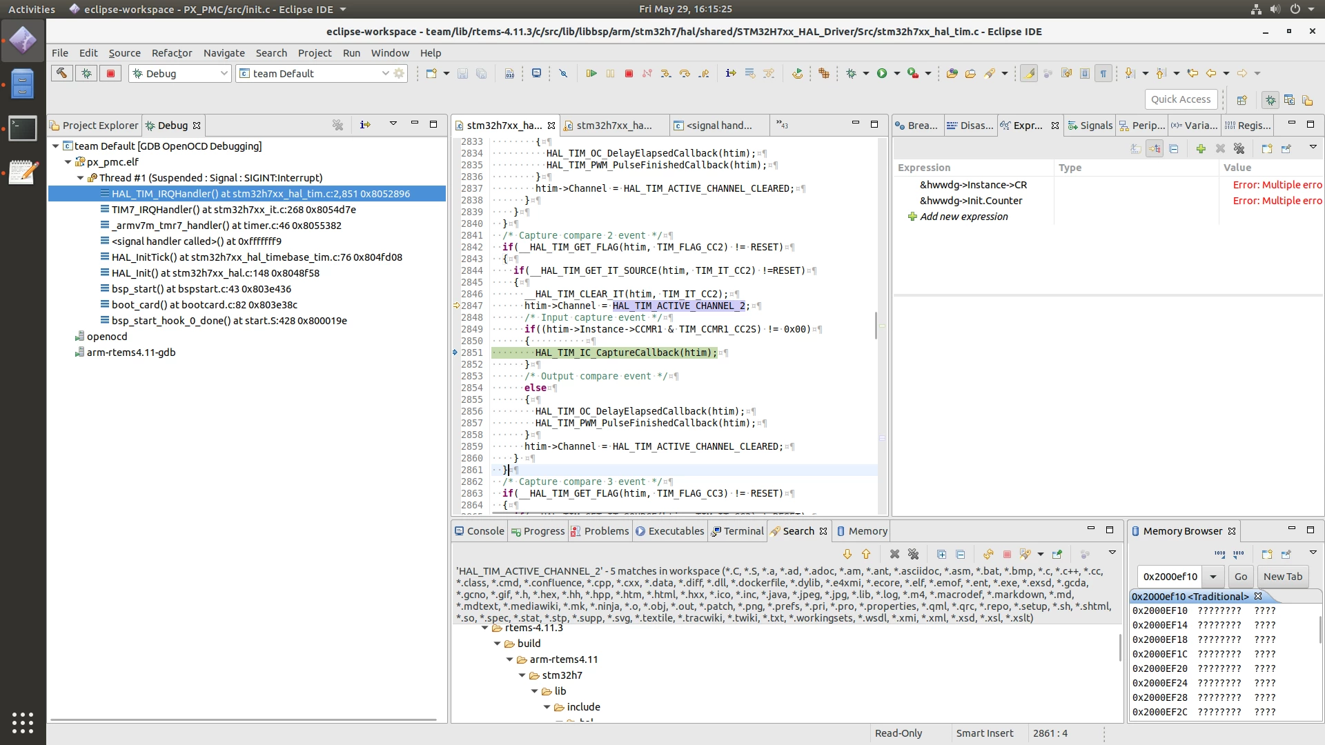

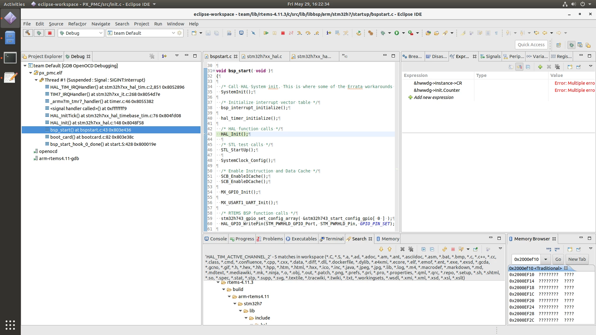

Please find the screenshot of the debugging information. After WWDG reset,TIM7CH2 interrupt is getting triggered until hard reset. After reset, TIM7CH2 interrupt is not triggering and application runs as expected.
I don't have a clue that why systick timer (TIM7 ) getting capture interrupt on WWDG reset.

It seems like WWDG trigger reset, but after the reset system tick timer (tim7 ) getting capture interrupt and code looping in the interrupt. Please look the following attachments.
