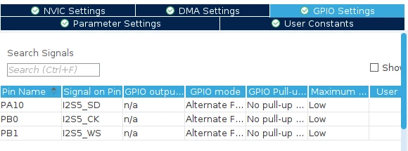

Just guessing: DMA is not your problem, maybe just the signal ->
H730 is really fast switching, so try: set port/pin speed to low , if not perfect then,  then try with a series resistor cpu/pin -> 100 ohms -> WS..../data line ; and check good solder contact to GND plane -> WS.../gnd line .
KKjel.1
KKjel.1Author
Senior
Jan 3, 2024 7:02 PM UTC
Fast response, thanks :)
When I use DMA, I have limited possibilities to set the port pin config: Both speed and drive strength is not available in CubeMX when the pin is not a generic GPIO port pin.
I will check and test with the limiting resistor.
AScha.3
Jan 3, 2024 8:10 PM UTC
Hey, DMA or not - you still use the pins and this you can set !
ie. here dma -> spi -> GPIO pins
