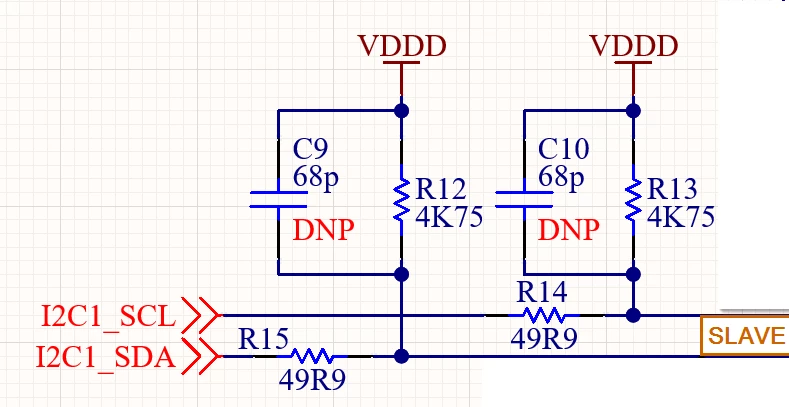

I am using STM32F303CB microcontroller, connected with a I2C slave which has no CLK stretching support. The I2C bus lines are pulled high with 4k75 ohms resistors and the lines have a serial resistor of 50 ohms (approx.). The schematic looks like the one in the image below.

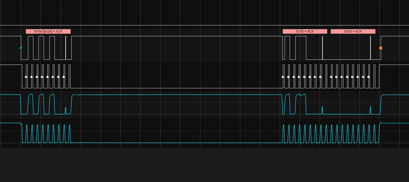

Normally, the transmitted data should look like the image below (0x2A -> slave address, 0x0A -> memory location inside slave, 0x00 -> data to be written inside that memory).
However, on these certain PCBs, the memory location byte of the slave is transmitted improperly over the I2C bus. The µC is "supposedly" transmitting 0x58 instead of 0x0A.

If it was a bit shift or something, I can understand this kind of error. But it was far from a bit shift. 0x0A -> 0x58 shift is something that I cannot understand. Hence, I tested the analog side as well, and noticed that there was no spur/glitch detected (500 MS/second).

> I tried to see if the correct value is being sent from the µC to the slave, and it is indeed correct.
I don't believe.
Hack into the routine where Cube/HAL actually writes the bytes into the I2C data register, and add a line, which outputs the bytes to something like UART or stores them to some global array or something similar.

Thanks for the response!
I tried the following condition inside the HAL_I2C_Master_Transmit_IT function (right after the I2C_TransferConfig() function)
if(hi2c->pBuffPtr[0] == 0x0A)
//toggle pin
Everytime I see the pin toggle. But my first question is, how can such a thing happen? The I2C itself does not hold any data, right? It always points to the array we create/declare. Then how can it be possible? And we are not speaking about one bit shift. That was my main question, actually.
