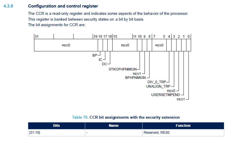

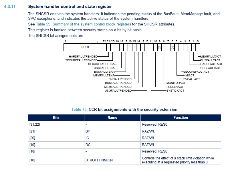

In document PM0264, chapter 4, section 4.3.11, it is referring to System handler control and state register (SHCSR) of the System control block (SCB).

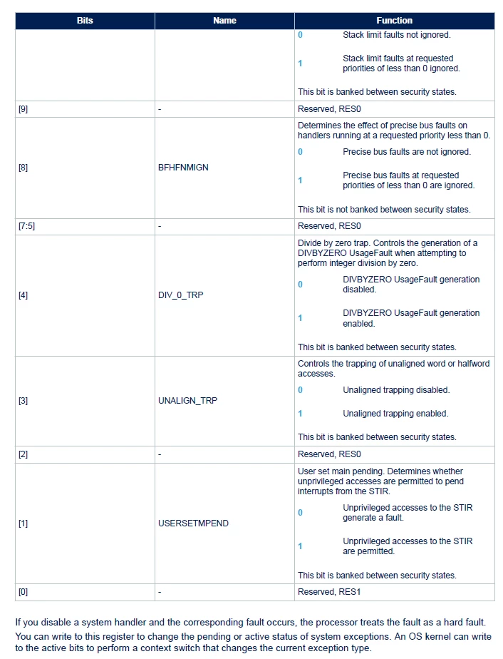

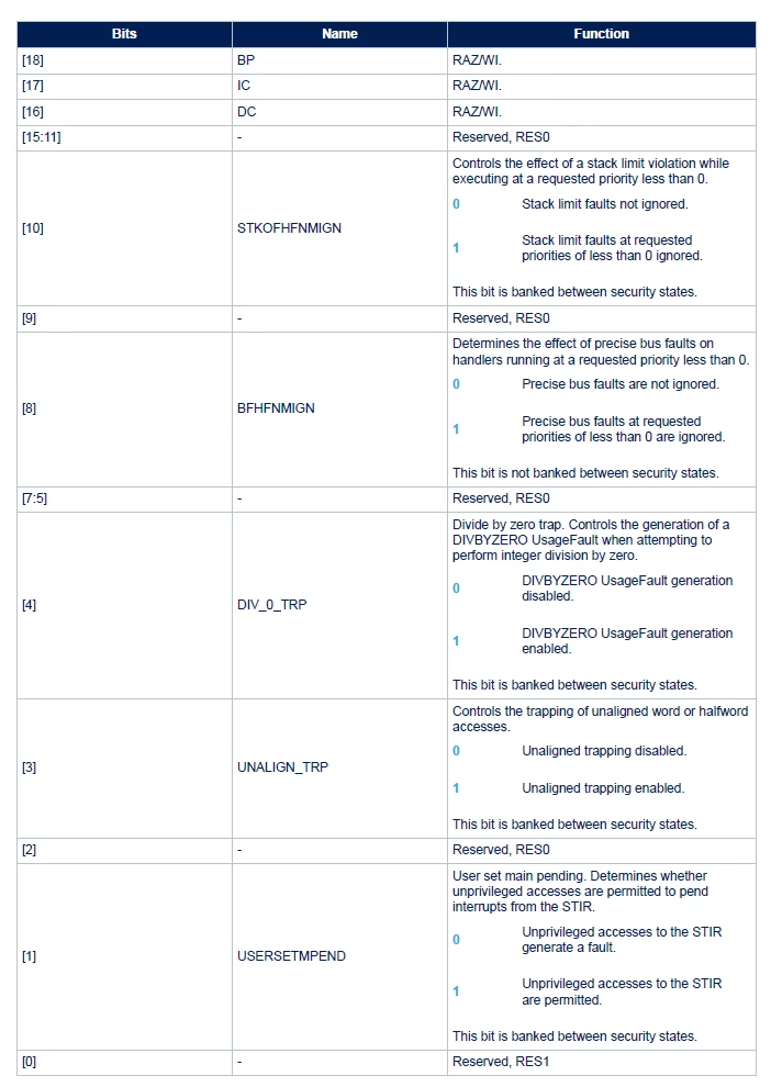

However, Table 75 of that section is describing the fields of Configuration and control register (CCR). It seems the content of table 70 of CCR register and table 75 is somewhat similar, and the fields of SHCSR register is completely missing!
Does anybody know if this is an issue with the document, or am I reading it wrong? I want to read more about SHCSR register but it’s nowhere to be found in this document.
Table 70:
Table 75:
