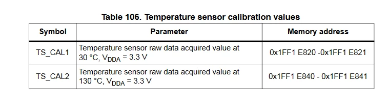

Wrong reference temperature given in ds H747
in ds for STM32H747xI/G  , DS12930 Rev 2 , for Temp.sensor CAL2 : 130° (Parameter) is written here:
BUT  max. temp for chip is 125° :
So i assume, this is misspelled  , because in all other : (H743, H750, H7A3 ..) 110° + 30° are given.
NOT 130° .
STTwo-32
STTwo-32Best answer
July 24, 2024
Hello @AScha.3
I can confirm that the TS_CAL2 value has been taken for 130° on the STM32H747xI/G.
Best Regards.
