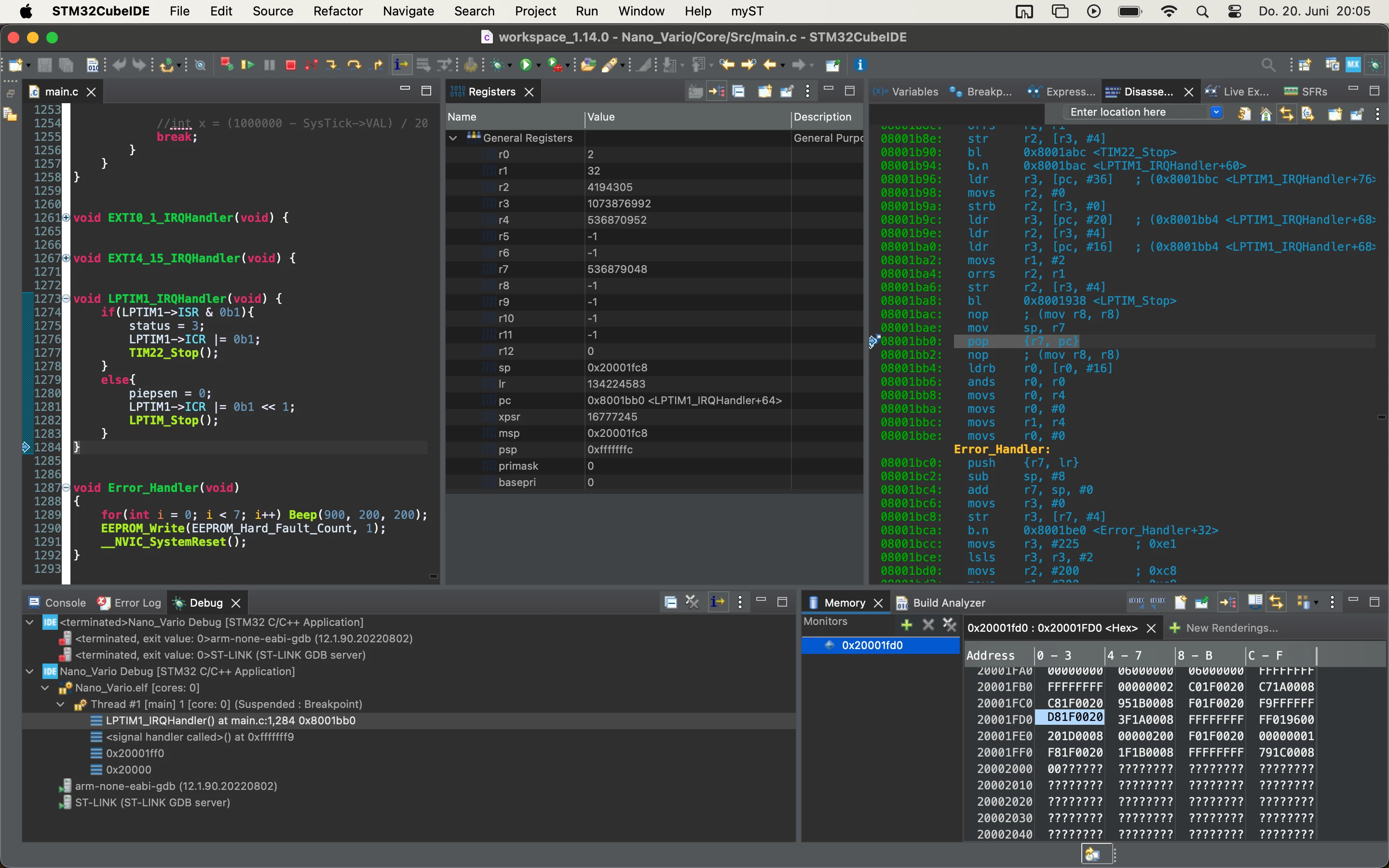

Wrong PC (progam counter) when exiting ISR
i'm using a STM32L031. In my code i first initialize the MCU (FLASH, CLOCK, INTERRUPTs, GPIOs), start the LPTIM (running on LSI), then slow down the MSI clock, start the timer22 for PWM and go into low-power sleep mode.  When i let the program run i experience an hard-fault after exiting the ISR (count = ccr) from the LPTIM because at the moment when r7 and PC gets popped from the stack PC gets a wrong value and suddenly points to RAM instead of FLASH. The strange thing for me is also, that when i don't use the LPTIM for waking up the MCU, but use a GPIO (EXTI) ist works fine. It also works fine when i don't go into low-power sleep mode but into stop-mode and then let the LPTIM wake up the MCU. In this case of course the PWM doesn't work while in stop-mode.
So can someone help me out an tell me why the pc gets a wrong value?
Here my example code:

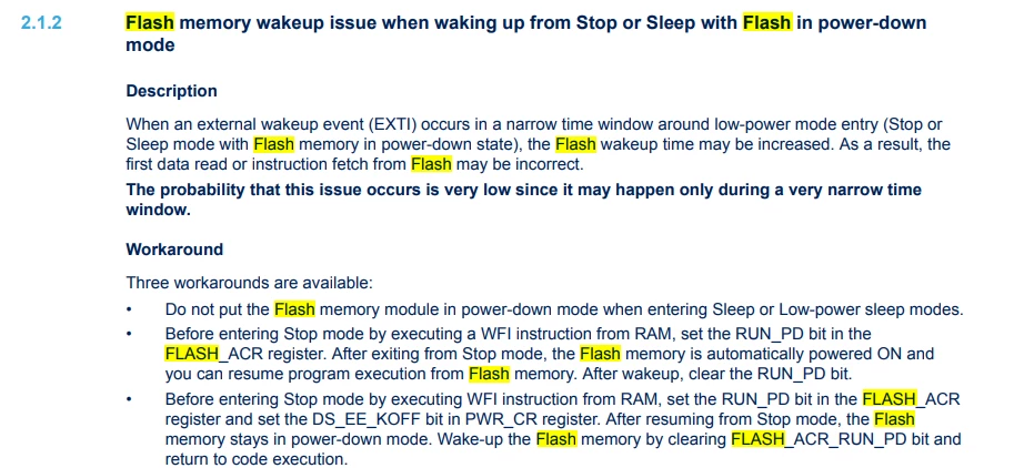

while (FLASH->SR & FLASH_SR_BSY) {} // Auf Flash warten bis alles erledigt
FLASH->ACR |= FLASH_ACR_SLEEP_PD; // FLASH schlafen legen
PWR->CR |= PWR_CR_LPSDSR; // Volt Regulator in Low Power Mode --> einziger vorteil wäre sonst schnellerer wake-up
__WFI();

The ISR looks like this:
void LPTIM1_IRQHandler(void) { // Überwachung Piepsdauer
if(LPTIM1->ISR & 0b1){ // Capture Compare Interrupt -> Piepsen AUS
status = 3;
LPTIM1->ICR |= 0b1;
TIM22_Stop(); // Abfrage damit nicht Gamification unterbrochen wird
else{ // Auto Reload Register Interrupt -> Pieps-Pause AUS
piepsen = 0;
LPTIM1->ICR |= 0b1 << 1;
LPTIM_Stop();

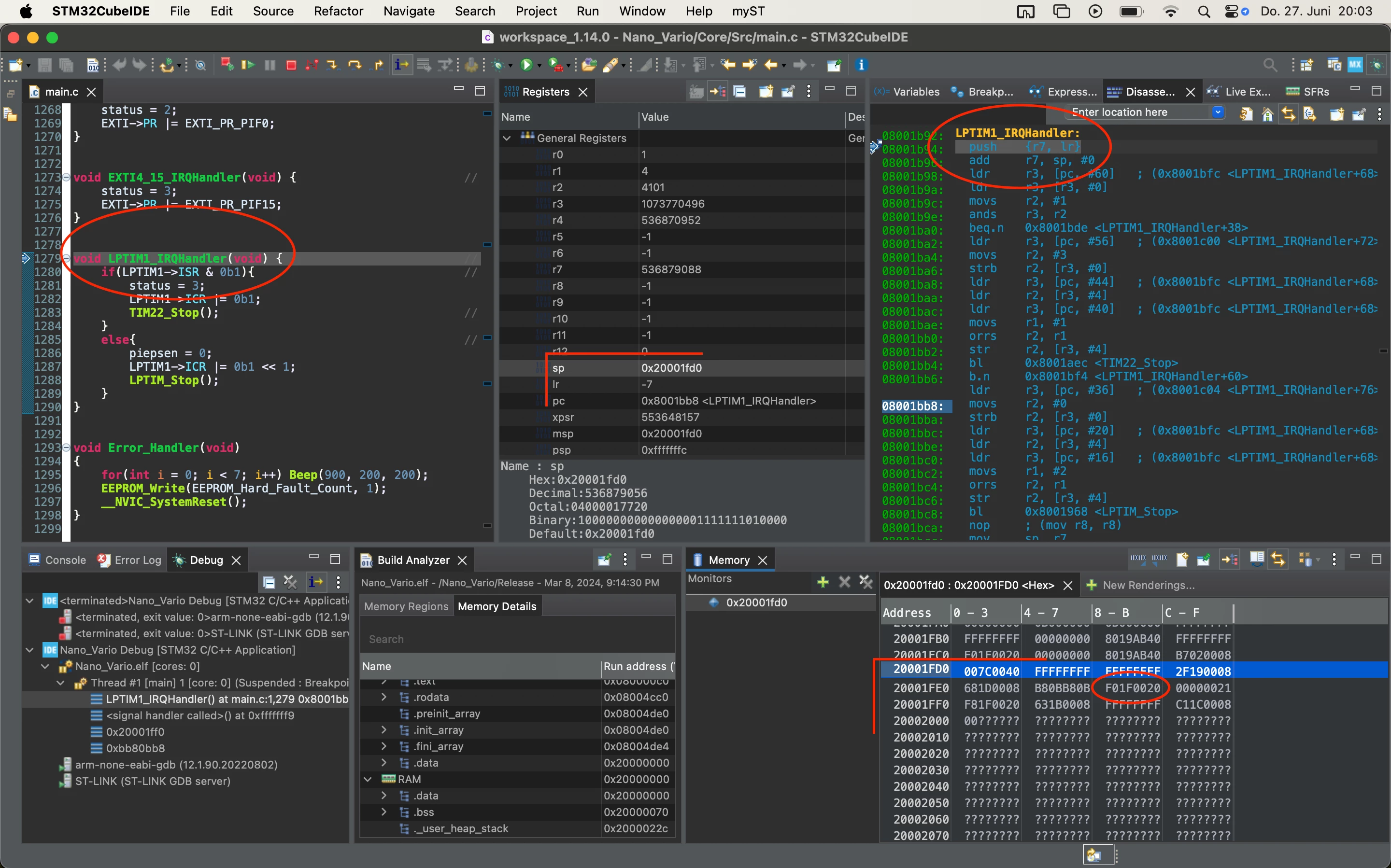

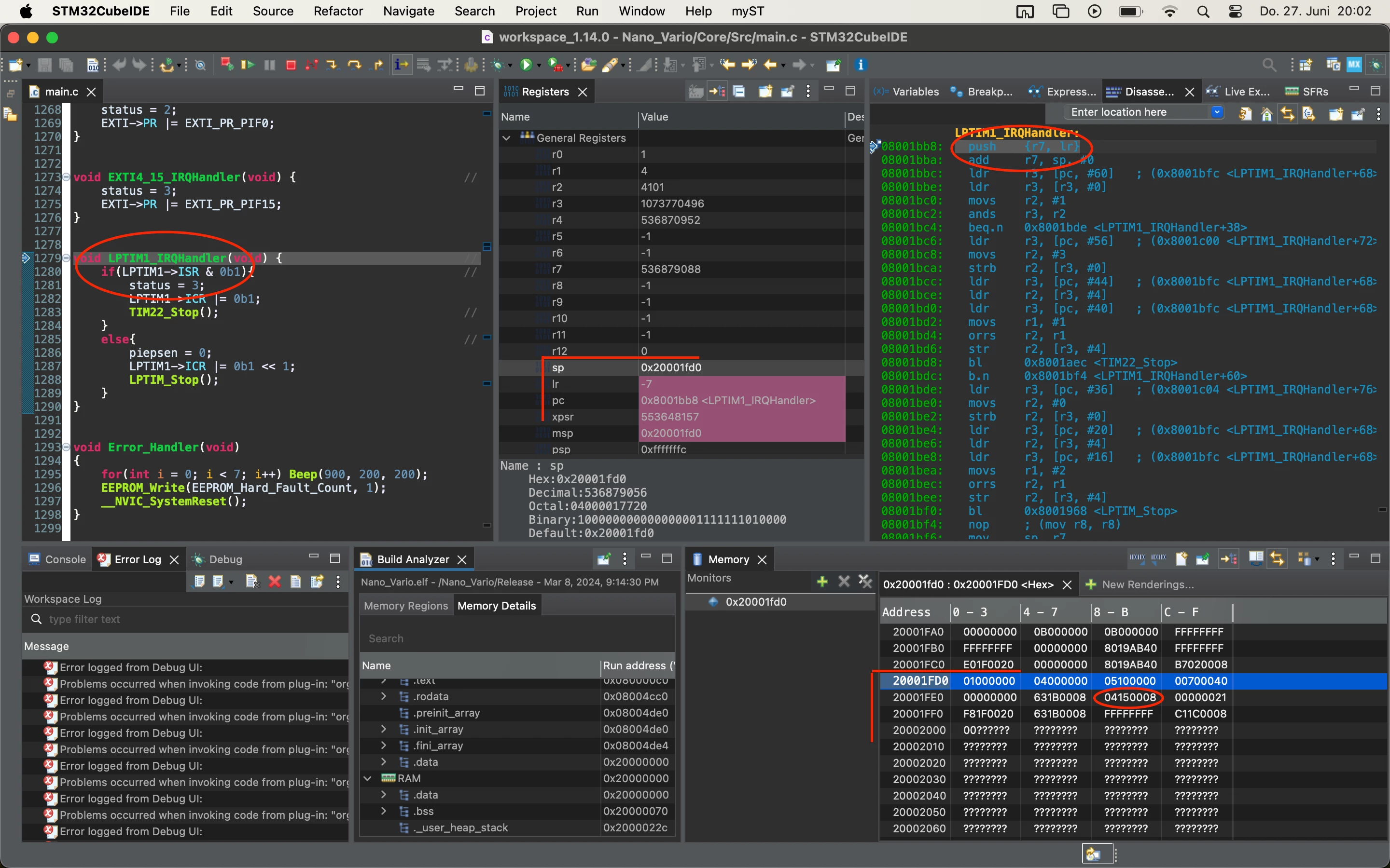

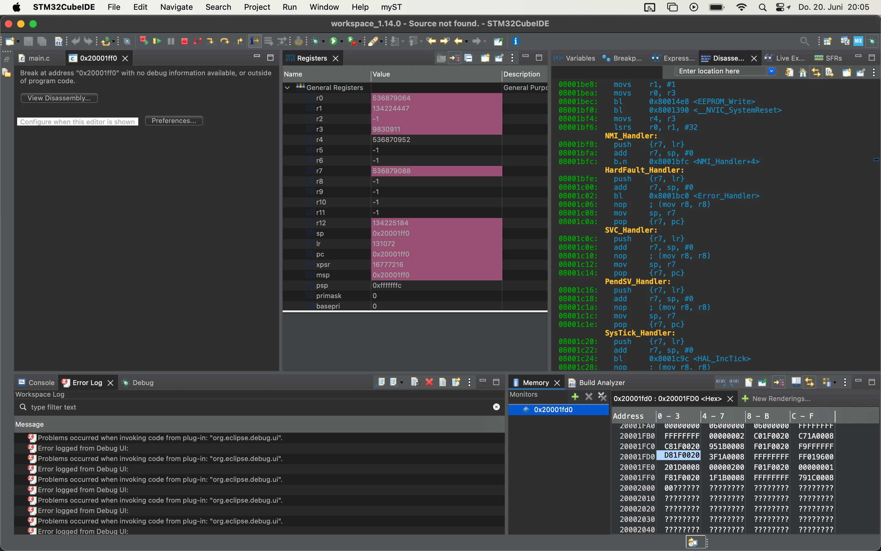

Screenshots:
1. In screenshot "Beginning" you can see the system right after the ISR was triggered.
2. Screenshot "Before" was taken just before the hard-fault happens.
3. Screenshot "Hard-Fault" doesn't need an explanation
Thanks in advance
Greetings from Salzburg, Austria

BrigeiAuthor
Jun 21, 2024 11:09 AM UTC
There are no other interrupts just the LPTIM interrupt. The sequence is like:
1. initializing
2. starting LPTIM in interrupt mode
3. starting TIM22 witb PWM
4. starting low-power sleep mode
5. waiting for interrupt. Because of the LPTIM settings (100ms and 200ms) it‘s guaranteed, that i‘m in this state when the interrupt happens
6. interrupt from LPTIM. there is no other interrupt going on and no callbacks.
7. Hard fault when exiting the ISR from LPTIM

waclawek.jan
Jun 22, 2024 3:53 PM UTC
There's only an empty loop after WFI. Why would r7 content matter?
BrigeiAuthor
Jun 22, 2024 4:00 PM UTC
The while(1) is only for testing purpose and r7 is not relevant for me. In my opinion it's only the program counter which has a wrong value when it is popped back from the stack. In the meanwhile i tried to put a Delay(1) right in front of the _wfi (instead of the debug break point) but i still get a hard-fault.
Tesla DeLorean
Guru
Jun 22, 2024 4:07 PM UTC
Seems like more going on here.
The RAM/FLASH should maintain in low power mode. Wait state or prefetch should also work.
Not clear why the stack would get trashed short of other things running, perhaps another IRQ or SysTick, or the power.
Have Hard Fault handler output diagnostics. Try to identify when the stack content gets damaged, and work that test backward to point it changes.
BrigeiAuthor
Jun 24, 2024 9:46 PM UTC

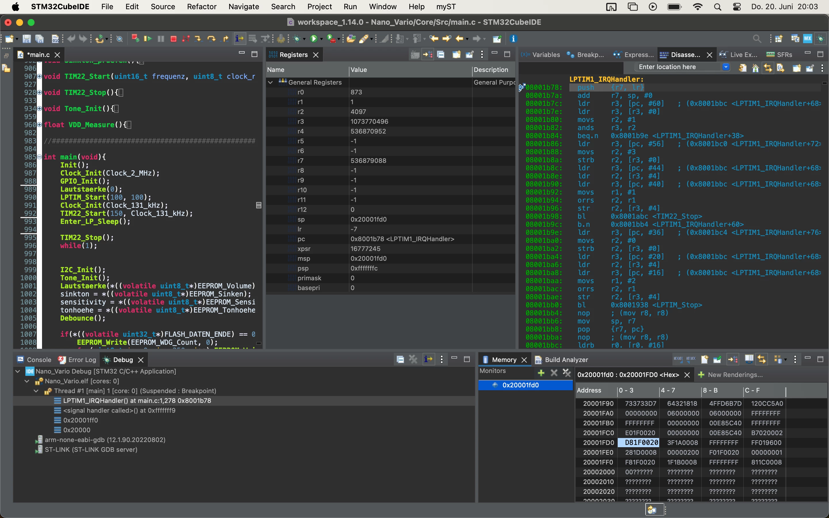

Unfortunately i can't explain why.  To previous asked questions: There should not be another IRQ or SysTick Interrupt. @Tesla DeLorean What did you mean with "or power"?
About the Hard Fault diagnostics: There is nothing in the 0xE000ED28 (CFSR), 0xE000E008 (ACTLR), 0xE000EFA8 (ABFSR), 0xE000ED28 (MMFSR) or 0xE000ED2C (HFSR) Register (just zeros) when the GDB stops in the Hard Fault Routine. (By the way is it normal that this registers aren't listet in de SFR View in Stm32CubeIDE? I have to look them up in the memory itself). Is there anything else i could do for diagnostics?

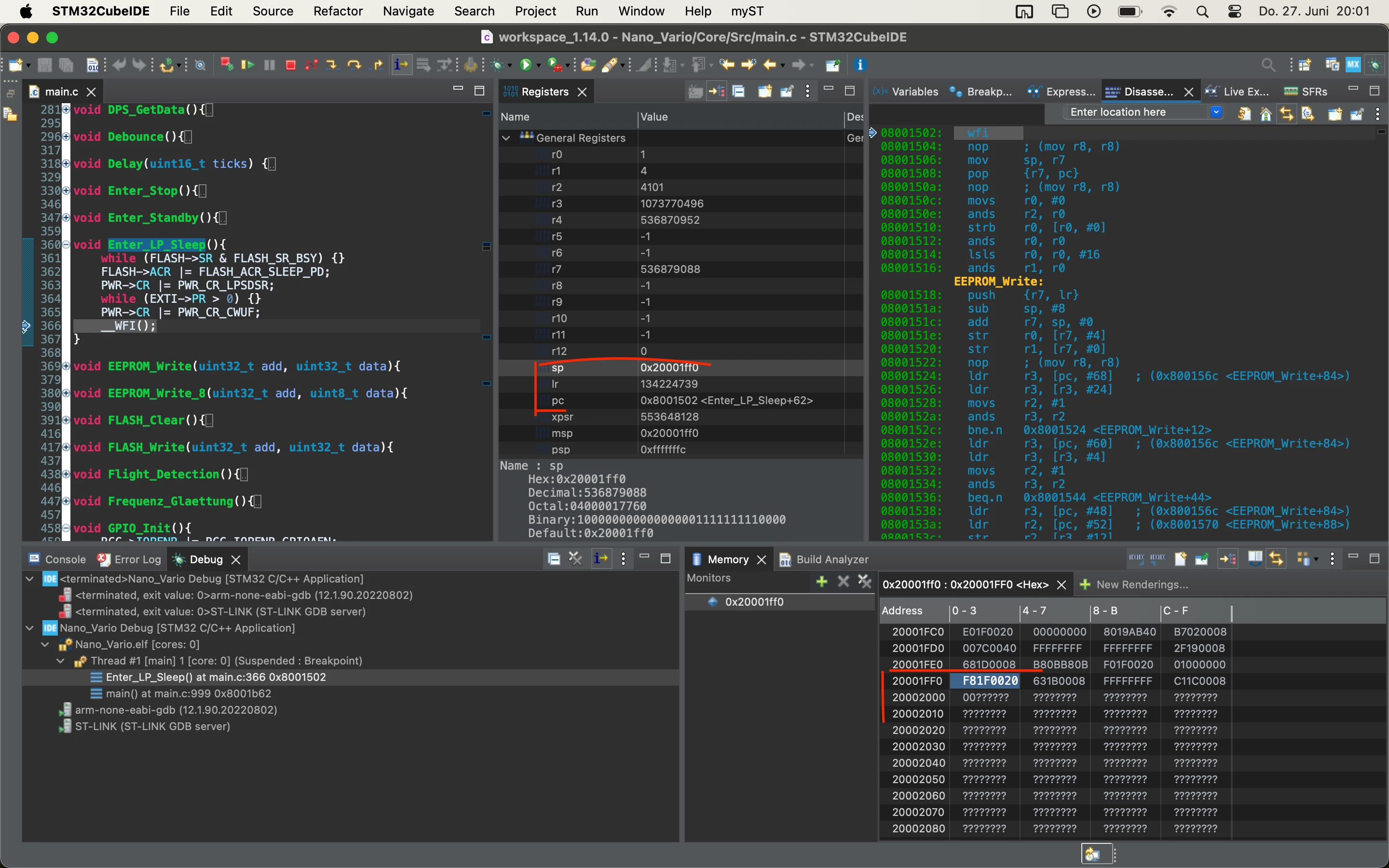

I also realized, that when i debug and set the break point at the _wfi (like i mentioned before) the mcu doesn't actually enter the sleep mode but just steps over it. There is no interrupt pending - so how come?!
Another thing - i noticed, that when i put the LPTIM and the Sleep Mode in "Debug Mode" (with DBGMCU->CR |= 1 and DBGMCU->APB1FZ |= 1 << 31) the MCU enters the sleep mode with _wfi and i don't get the hard fault neither.
When i debug step by step everything kind of looks normal to the point where i let the MCU run with the play button. Then i always end up with the corrupt stack. How can i just get one step backwards? Or is there a proper way to debug the sleep mode? There must be something in between the _wfi and the interrupt by the LPTIM.
Tesla DeLorean
Guru
Jun 24, 2024 10:09 PM UTC
That power to critical circuits or clocks was lost, resulting in the RAM or MCU state getting compromised.

Show content of stack before WFI() and after it (i.e. at the beginning of the ISR which woke up the processor).
BrigeiAuthor
Jun 27, 2024 6:14 PM UTC
  1. Break before _wfi --> everything looks NORMAL
  2. After continuing from Step 1. break at ISR LPTIM --> pc in stack frame is OK
  3. From beginning without breaking at _wfi --> pc in stack frame ist CORRUPT
waclawek.jan
Jun 27, 2024 9:32 PM UTC
Interesting.
In the problematic case, the ISR stacking goes wrong and only one of the 8 words (PSR) gets actually stacked. As if the SRAM would be unavailable for the core immediately after the wakeup.
Now I don't know why is that, but to me this thing is suspicious in your code:
// Slow down clock
RCC->ICSCR &= ~(0b111 << 13);
RCC->ICSCR |= 0b001 << 13;
while(!(RCC->CR & RCC_CR_MSIRDY)); // Wait for MSI is ready
Here, you switch the MSI speed *twice* - first you set it to range 0 and immediately after that to 1. Don't do that.
Try to place a bunch of NOPs or a loop just before WFI, just as an experiment.
Also, how are RCC_AHBSMENR bits set?
PS.
> has the value 0x80001B63 which ist not aligned?! Should it be? After the value is popped the program jumps correctly to 0x80001B62
That's OK. The Cortex-Mx processors don't use the original 32-bit ARM instruction set, but the 16-bit Thumb instruction set, and there, the LSB of address indicates the Thumb mode.

Jul 2, 2024 4:19 PM UTC
Hello @Brigei
check STM32L031xx/L041xx device errata - Errata sheet section 2.1.2 :
waclawek.jan

Jul 3, 2024 10:44 AM UTC
Hey @waclawek.jan,
This is related to the flash wakeup time when the system is waking up from LPSLEEP.
The first instruction fetch from Flash after waking up is incorrect due to the Flash not being ready (as described in the errata, recovery time is needed), the POP that attempts to restore the PC from the stack could end up fetching the wrong address for the PC, and the CPU will resume execution at an incorrect address leading to hardFault.
As the workaround suggest and I think @Brigei tested it, removing the line that puts the flash in power down mode will solve the issue.

If you look at screenshot in 3.jpg in @Brigei 's post above, PC points to the correct address of first instruction in LPTIM1_IRQHandler(). However, what is not correct there are the stacked registers.
Also, the whole thread is about the fact, that the hardfault does *not* occur immediately after the wakeup, but that *whole* LPTIM1_IRQHandler() after wakeup is executed correctly (that's many many fetches from FLASH, all correct), and that the hardfault occurs upon *exit* from LPTIM1_IRQHandler(), when the incorrectly stacked PC is popped from the stack.
So, as I've said above, the problem is *not* incorrectly woken up FLASH, but that 7 out of the 8 register values stored to RAM during the stacking upon ISR entry are not written by the processor into RAM at all, and those RAM places retained their previous values. Again, refer to the screenshots in @Brigei 's post above and their descriptions, they very clearly indicate the problem, and it very obviously is NOT consequence of incorrect FLASH fetch.
That the problem appears to go away by disabling FLASH powerdown, is IMO coincidental, thus without further investigation of the true mechanism of problem should not be considered to be a solution to this problem.
