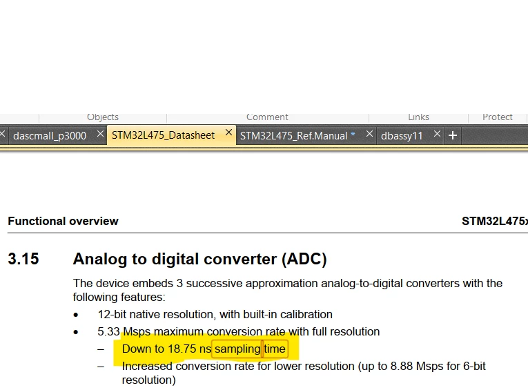

Wrong min. sample time mentioned in the STM32L475 data sheet.
The min sample time is 2.5 ADC clock cycles and max.ADC clock is 80MHz, with this the sampling time is coming as 31.25ns but you mentioned as 18.75ns. Here, I think ST has taken the ADC clock cycles are 1.5. I felt it as a bug.

Hello @Community member​ ,
Thanks for reporting this Typo
The sentence is wrong, and it should be corrected as follow:
“Down to 31.25ns sampling time�? Or “Down to 187.5 ns conversion time�?

I have raised internally the DS typo for fix in next release.
Thanks again.
