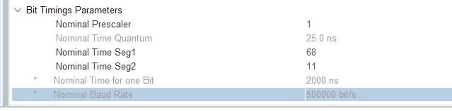

Upload your IOC file so we can see your clock and baud rate settings.

IOC file attached, i.e. the one where the problem occurs.

It's recommended to use HSE instead of HSI for the clock.
Try these recommended settings for the CAN baud rate.
