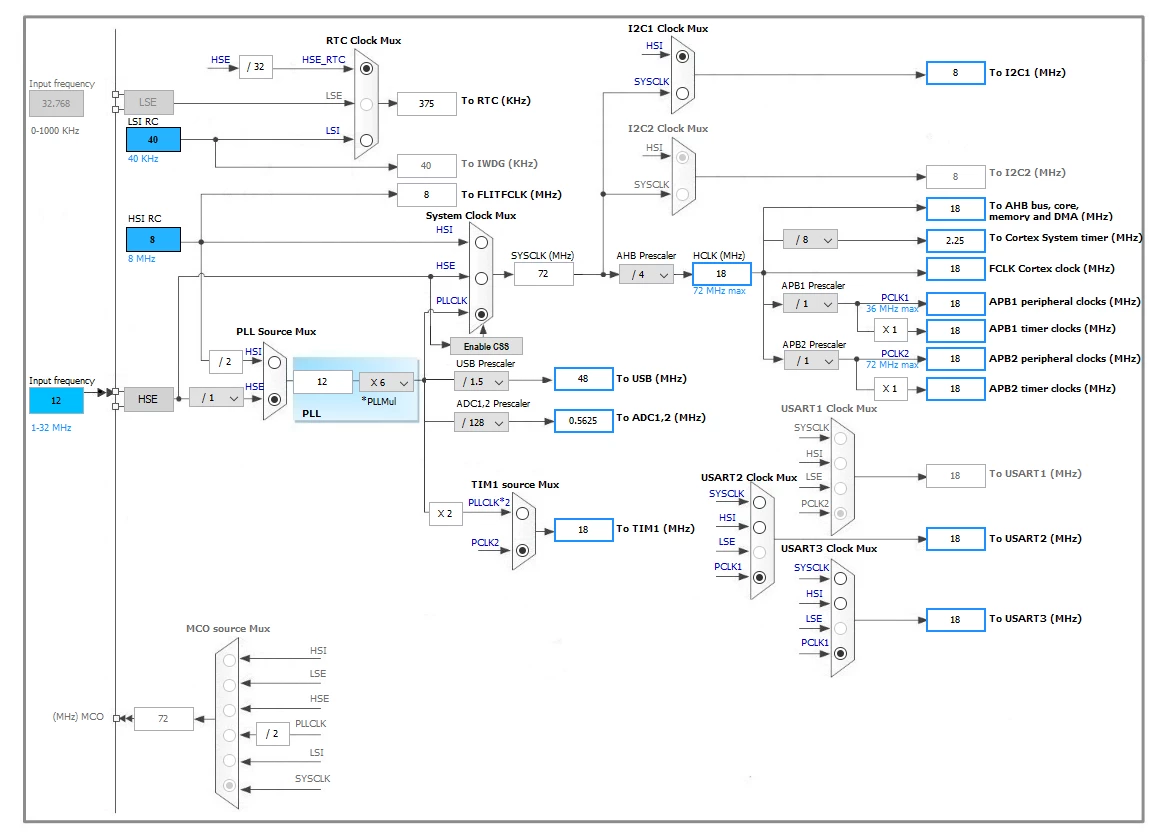

I use an external 12 MHz clock source and this configuration in CubeMX 4.25.1:
According to RM0365 the flash access time depends on HCLK not SYSCLK like in RM0008 (STM32F1...), but I tried two other configurations which indicate that flash latency should rather be set according to SYSCLK:
SYSCLK = 72 MHz, HCLK = 9 MHz -> program crashes
SYSCLK = 48 MHz, HCLK = 12 MHz -> works
Did I overlook something else or is this a bug in the reference manual / CubeMX?

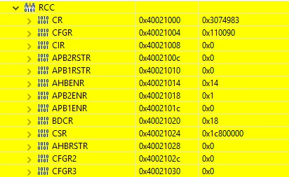

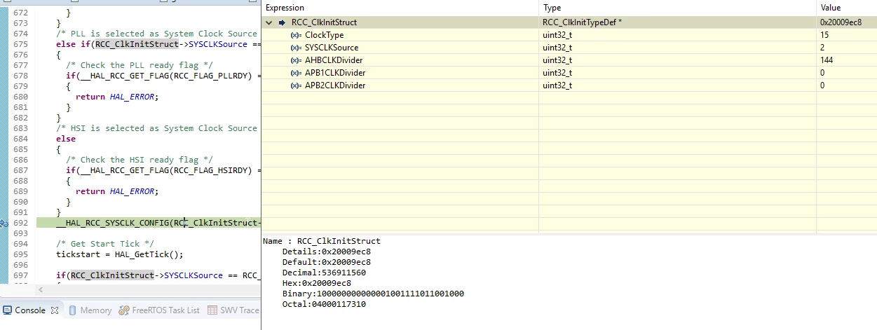

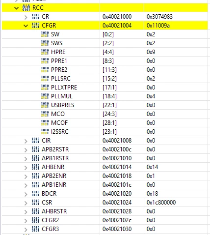

    Is RCC_ClkInitStruct properly initialized (i.e. filled all its fields)?
    __HAL_RCC_SYSCLK_CONFIG(RCC_ClkInitStruct->SYSCLKSource);
    Read out and check/post the RCC registers' content just before that line.
    Moritz Diller
    May 21, 2018
    Posted on May 21, 2018 at 09:36
    Before __HAL_RCC_SYSCLK_CONFIG:
    After __HAL_RCC_SYSCLK_CONFIG:
    RCC_ClkInitStruct:

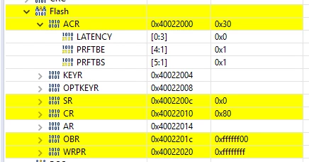

    One more thing from reading the RM:
    The prefetch buffer must be kept on (FLASH_ACR[4]=’1’) when using a prescaler different from 1 on the AHB clock.
    Can you please read and check FLASH_ACR?
    Moritz Diller
    May 21, 2018
    Posted on May 21, 2018 at 15:05
    Prefetch buffer is enabled, when the fault occurs:

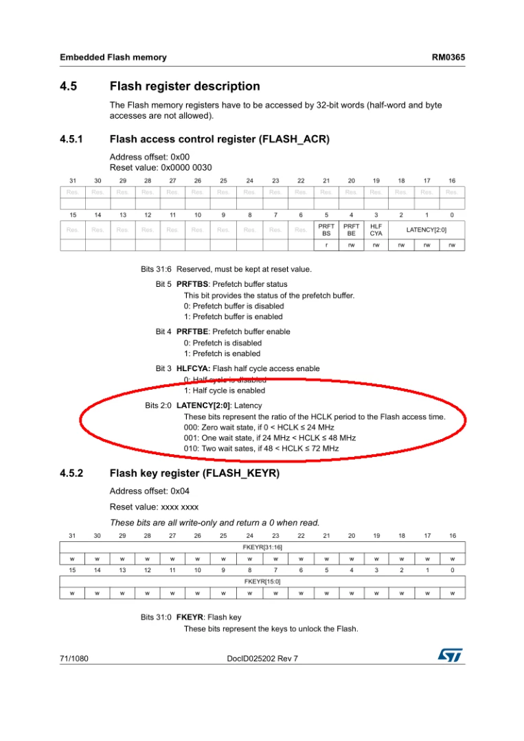

    GHARBI.Nawres
    The RM clearly states that latency is based on HCLK:
    Are you suggesting, that a serious error in RM (and, presumably, in other 'F3xx RMs) is to be fixed in CubeMX???
    Jan Waclawek
