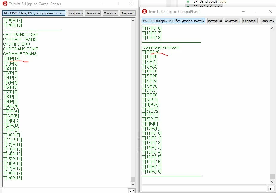

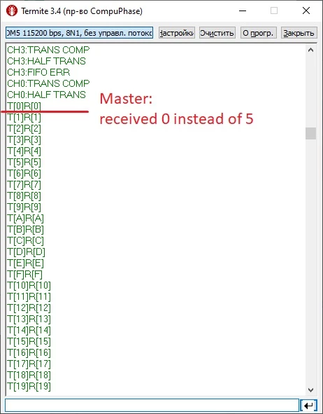

Problem is that in receiving back data by master. First byte has always corrupts.
Lower SPI speed does not solve the problem.

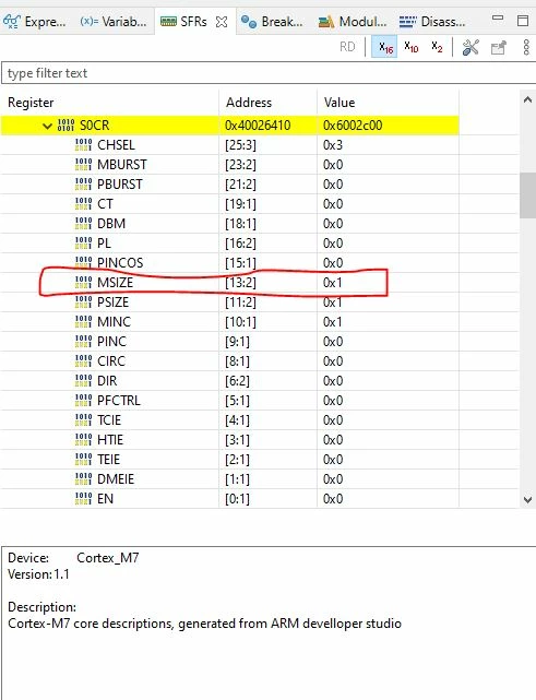

Second question is about MSIZE bit. Why it is set to "0x1" against my code?
From the reference manual:
In direct mode, MSIZE is forced by hardware to the same value as PSIZE as soon as bit EN = '1'.

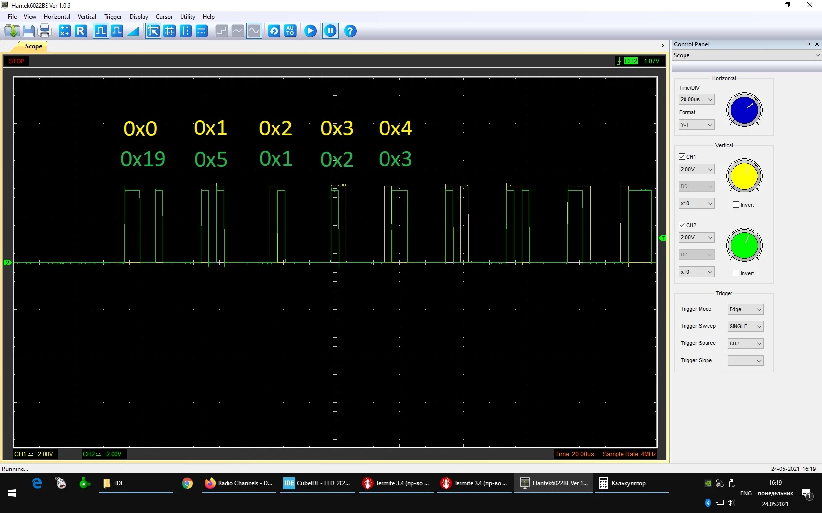

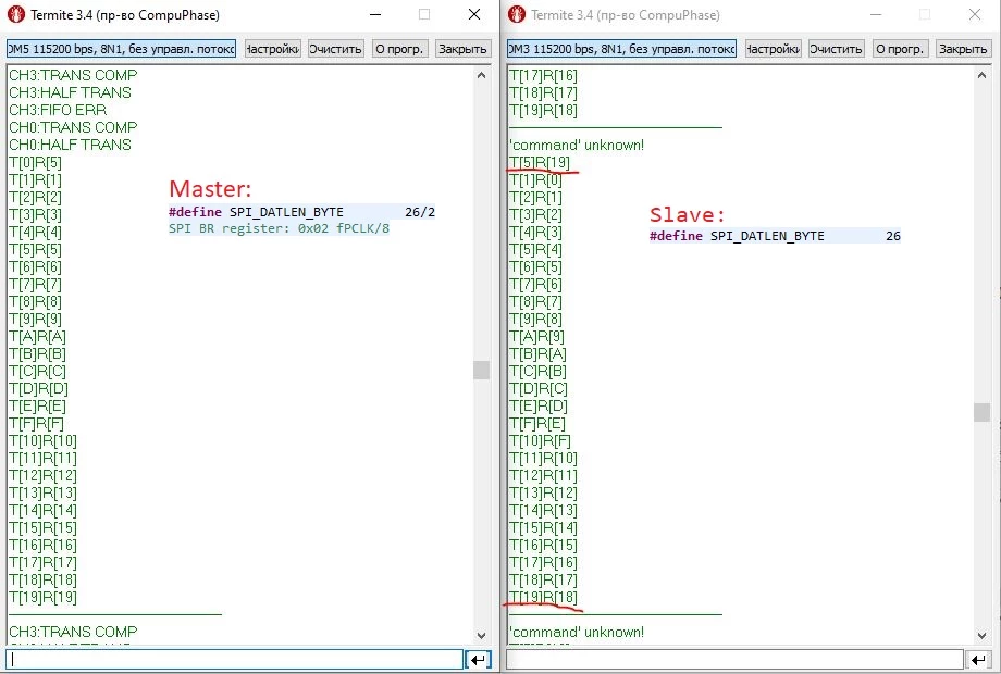

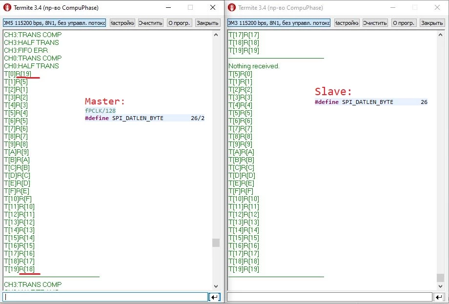

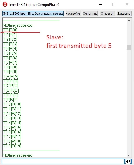

Ok so i have inspected with oscilloscope. First thing is that no incorrect byte is received (just wrong 'printf' timing).
But new problem appeared. The data shifts on one byte: in case of SPI clock is about F_PCLK/4 - on the slave side. If SPI clock is F_PCLK/128 - on the Master side.
See screeshots.
By the way i have noticed that the master(F7) sends 26 bytes twice. I reduced 'SPI_DATLEN_BYTES' to 26/2. Ok, this settings is not a byte count, rather it is "item count".
But why on the slave(f103) side i leave this option as 26? SPI has the same DR 16 bit long!!? how it works.
DVovk.1
DVovk.1Author
May 24, 2021
Green - MISO
Yell - MOSI
SPI speed is about PLCK/128

Set PSIZE to the size you want to send, in this case 1 byte.
DVovk.1
DVovk.1Author
May 24, 2021
PSIZE 0x0 8bit
MSIZE 0x0 8bit
SPI speed max: 72MHz/4

You're not waiting for the transaction to complete. You're starting the transfer and then immediately calling printf on the RX buffer (which doesn't have new data yet), so you're getting the value from the previous transaction.
DVovk.1
DVovk.1Author
May 24, 2021
Yes, i have updated the code. Now it prints right. Please see oscilloscope shot, there are wrong impulses at the begin.
May 24, 2021
I don't see an oscilloscope plot.
Keep in mind pins can toggle during initialization. Typically this is solved by keeping the CS line high.
I would suggest having a closer eye on the Reference Manual if you're going to use register access for everything.
DVovk.1
DVovk.1Author
May 26, 2021
Finely problem was that FRXTH was '0'.
0: RXNE event is generated if the FIFO level is greater than or equal to 1/2 (16-bit)
1: RXNE event is generated if the FIFO level is greater than or equal to 1/4 (8-bit)
Now it works fine at maximum speed 72/4 MHz.
Thanks for answers!
