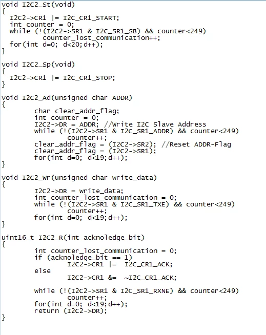

I'm still having trouble with my I2C communication.
I'm using the Bus as Master, at the moment without any Slave.

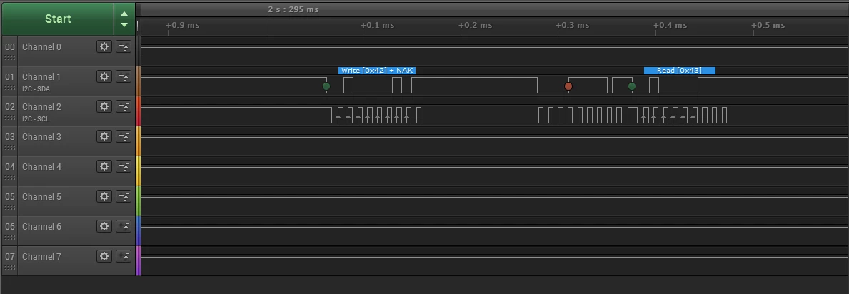

After sending the Device Addr, which is transmitted correctly to the ouput (checked with logic analyser) I send data which is then put to the output wrong. When sending 0x0F I get with the logic analyser 0x1E on the Data line.
For the I2C communicatoin I'm using a exit counter to leave the otherwise endless while-loops.
	I2C2_St();
	I2C2_Ad(0x42);
	I2C2_Wr(0x0F);
	I2C2_St();
	I2C2_Ad(0x43);
	I2C2_R(1);
	I2C2_Sp();
Can someone help me how to fix this?

    Your capture doesn't show the first start bit. the timeframe is too zoomed.
    I see only a start bit at the mini green disk.
    Logic analyser should be used AFTER a check of I2C lines by oscilloscope.
    Maybe toggle a GPIO at the beginning of the I2C sequence to trigger on it with oscilloscope.

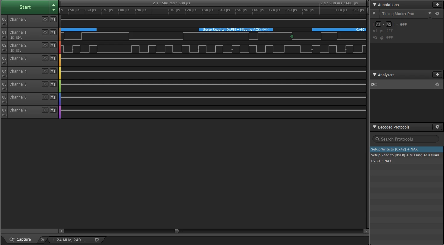

    0690X000006DTB4QAO.pngHi,
    added the full waveform:
    Image is not available
    I hope this helps?

    You are missing a restart.
    Your oscilloscope seems wrong, it's MSB bit first 0x01 shows up as 0x80.
    S-42a-01a-S-43a-xxa-xxn-P

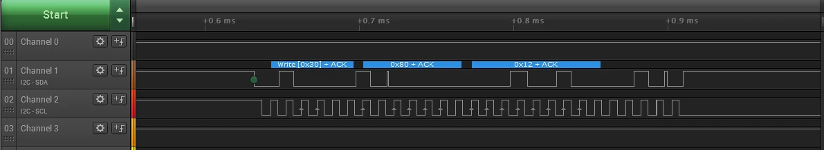

    When I add a stop-start condition, the stm32f4 does only send: S-42a-01a-S and th0690X000006DUzQQAW.pnge second address and register address is lost.
