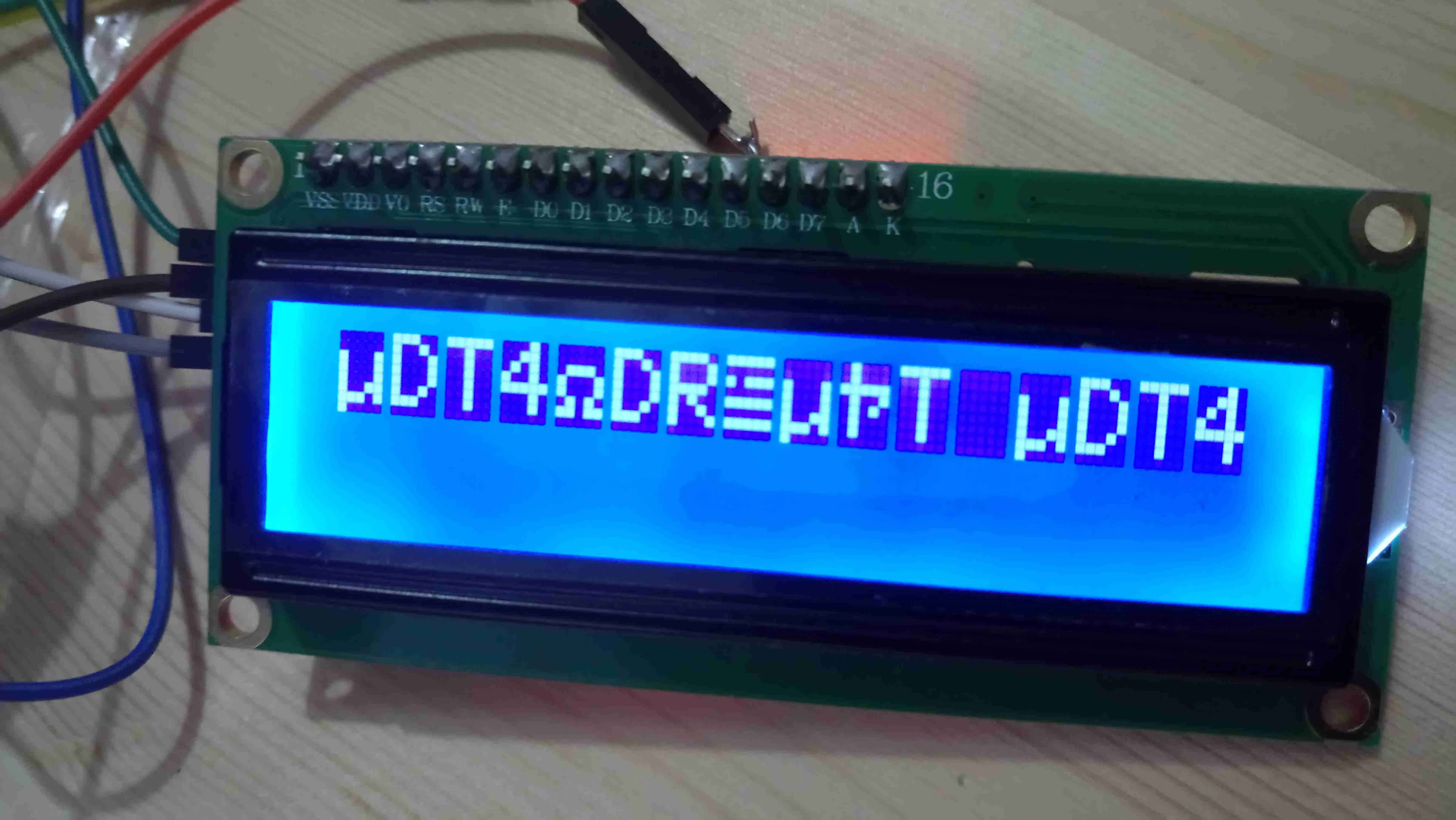

Dear Members,
I got a wrong data on I2C 2 for LCD, the first time it was ok, after a while it becomes like in the photo, what do you think the cause of it ?
I have put a pull up resistor for it 10K, and the speed is 100KHz,
I2C1 for Accelerometer and temperature,
Is it because of power supply or something else ?

As I recall you have an IO Extender, with 4-bit connectivity, I'd suppose the two halves aren't getting cleanly latched.
Perhaps review with a logic analyzer, and review setup/hold timing requirements of the display.

............. I'd suppose the two halves aren't getting cleanly latched....
do you mean between expander and the LCD ?

I reduced SCL to 50KHz, still got the same response, after GPS is on or accelerometer is on...

Ok, so you've established that the speed of the I2C interface isn't the issue. Now you need to review the performance of the signals to the display's micro-controller, and how the edges/transitions of those relate.

when I make time out =100ms
HAL_I2C_Master_Transmit (&hi2c2, 0x7E,(uint8_t *) data_t, 4, 100);
it's reducing the error, is it the cause or something else ..?

I reduced SCL to 40KHz, it's now stablizing,
 hi2c2.Init.ClockSpeed = 40000;
I keep posted, perhaps, I need to reduce the clock lower ....Iet's see...
