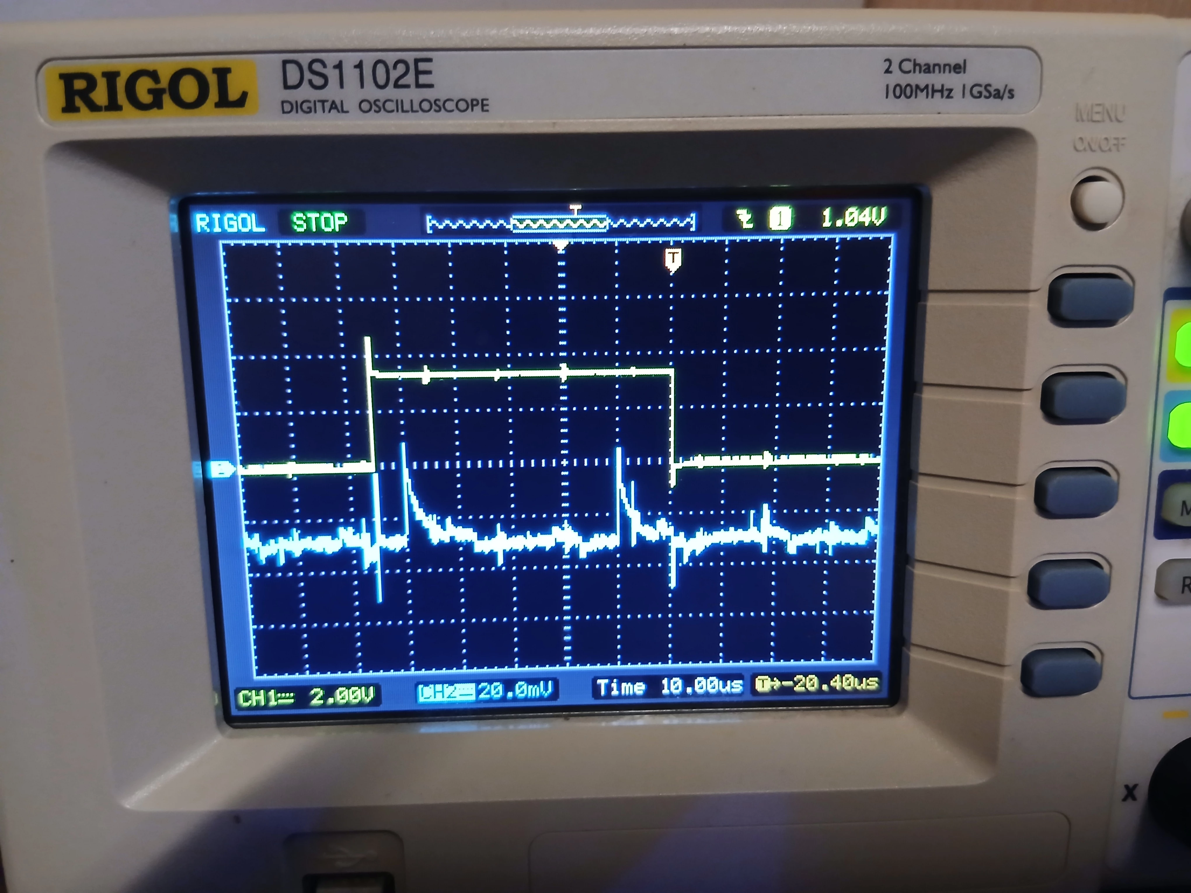

I have connected oscilloscope to ADC input pin directly to see
sample begin. As ADC capacitor is connected to input and it has some charge
it is possible to see discharge curve on the screen.
Here is the picture.
Yellow shows time between start and end of sampling.
Blue shows sampling begin (when capacitor is connected).
Why there are two discharge curves?
I have configured to do only one sample.
Also the timing is wrong.
I am using clock from external HSE.
It is 16MHZ. Divider is 32.
ADC is 12 bit so hold time is 12.5 clock cycles.
Sampling time is 5 clock cycles. (SPE is 0).
Now the time should be:
(12.5+5) * (1/16*32) = 35us
But the time on the screen is 55us.
I guess it is due to two samples but why there are two samples?

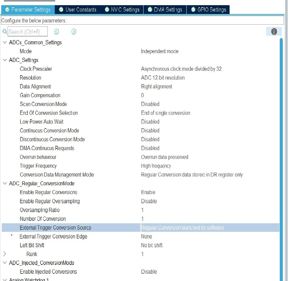

Here is screenshot from cube mx with ADC1 configuration.
Thanks.

One spike when the channel is connected, another when it is disconnected. Maybe, not 100% sure.
Timing is “wrong” because you are toggling a pin before to start and after the end of the sampling, not at the same time, so there is overhead in your measurement. Toggling a pin is not an accurate method of directly timing the ADC sampling rate.
Do 100 samples using DMA to a single buffer and time it using the toggle pin method, then do 1100 samples and time it. Take the difference and divide by 1000. That will be an accurate measurement of the sampling rate.

Maybe you are right that second discharge is capacitor disconnection.
So the time between connect and disconnect is 40us.
It is sample time. In my setup it is 5 adc clocks so the time should be
5 * (1/16 * 32) = 10us.
So something is wrong here.

Let’s see what the RM has to say:
So sampling is 5 cycles according to you. And resolution of 12 bits is 15 cycles (not 12.5).
So 20 cycles total.
With a 16 MHz clock and /32 prescaler, this is 20 * 32 / 16 MHz = 40 us.
I think it may be doing 2 samples and not 1. Doing the timing exercise in my last post would give the correct timing. Or doing more than 1 sample.

Yes you are right. I choosed wrong conversion time from ADC4 table.
The whole time is 40us. It is exact time between discharge curves.
But why second discharge curve is present and why there is additional
10us delay before interrupt?
Only one iterrupt is generated after conversion I checked that.
If second discharge curve is sampling why there is no interrupt?
I have checked that pins set/reset takes about 200ns so it does not
affect the measuremetns much.
Currently I want to understand why second discharge curve exists.
