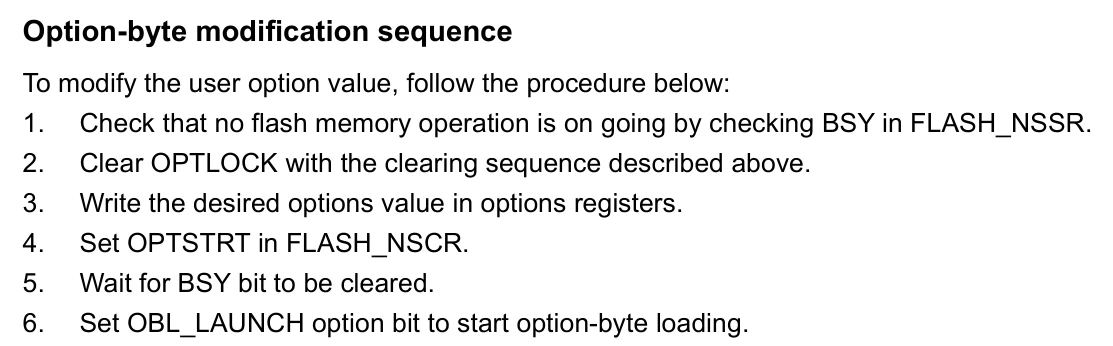

My current plan was to use the read memory command and read the register FLASH_OPTR at 0x4002 2040 and then read bit 20 of that register(SWAP_BANK bit) then perform an operation on that bit to swap the banks. Then I would write the new value of the register using the Write Memory Command. My initial thought was that I only needed to read 4 bytes and then write 4 bytes, but after researching I am concerned if that would be problematic. Will it be a problem to only try to read/write the 4 bytes of the reigister?

> What does it mean by all bytes are erased?
Option bytes are in flash. It needs to erase the entire block of option bytes and then rewrite them all when any of them are modified because that is how flash operates. Only option bytes are erased, not user program memory.
The registers are an interface to the option bytes. The actual option bytes reside in flash.
You can only read/write 4 bytes of the register. No problems there. Provided you unlock them first. Option bytes still need to be loaded after you write to the registers.
See "7.4.2 Option-byte programming" in the reference manual for the correct procedure to modify option bytes.
