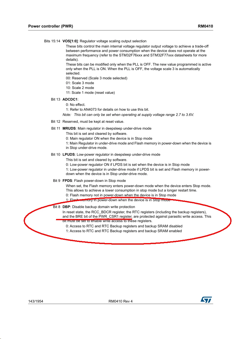

Sep 4, 2020 11:53 AM UTC
Oliver,
Nice catch!
> I can't see it in the manual but you need to set PWR->CR1 DBP before you can set BRE.
It is documented, sort-of, but not where you'd expect it:
