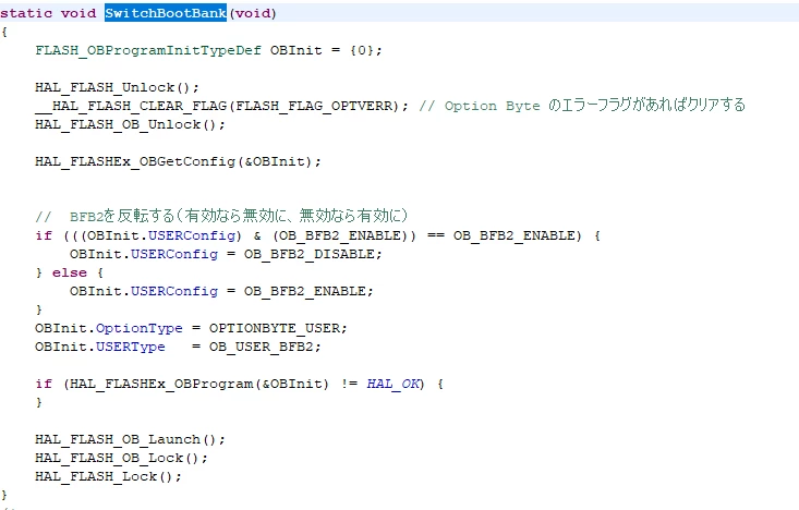

I'm using STM32G474 with dual-bank Flash enabled (nDBANK = 0) and booting from Bank2 (BFB2 = 1). I'm implementing OTA firmware update by writing to the inactive bank while executing from the active one.
The update from Bank1 → Bank2 works fine.

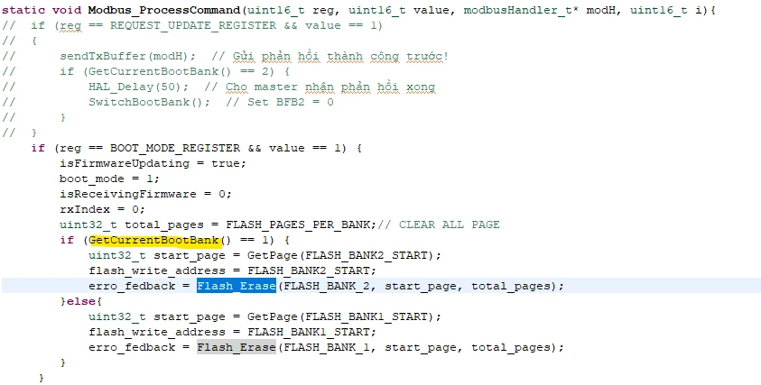

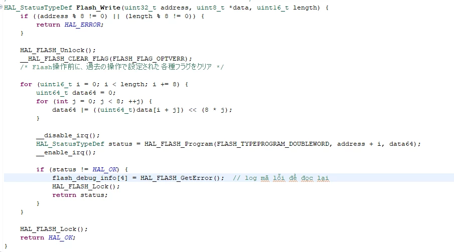

But in the second update cycle, when running from Bank2 and trying to write to Bank1 (starting at address 0x08000000), HAL_FLASH_Program() always fails on the first double-word.
I have:
  • Verified that Write Protection is disabled (checked in STM32CubeProgrammer)
  • Unlocked Flash properly

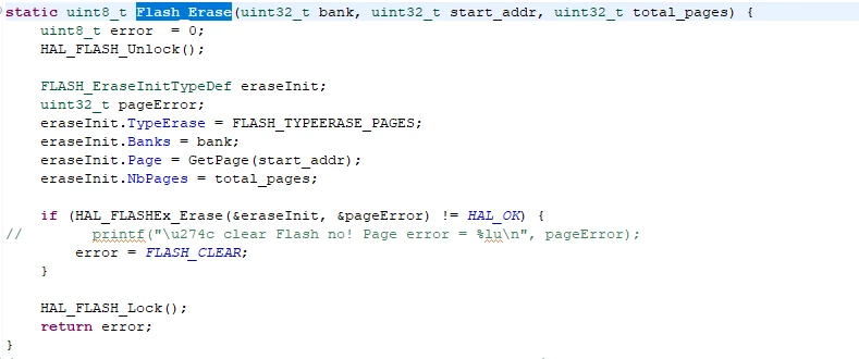

  • Erased the target pages beforehand
  • No PCROP or secure area configured on Bank1
  • Flash error flag is HAL_FLASH_ERROR_WRITE_PROTECTION sometimes (even though WRP is not set)

In my project, I am using a dual-bank firmware update mechanism, where:
- If the MCU is running from Bank1, it writes firmware to Bank2
- If it's running from Bank2, it writes firmware to Bank1
To simplify the workflow, I am trying to **use the same `.bin` file** (built with vector table at 0x08000000) for both cases — writing it to either Bank1 or Bank2 depending on the current boot bank.

When the device starts from Bank2 (with BFB2 = 1 set), the memory map is remapped as follows on STM32G4 series:
  • Bank2 is remapped to 0x08000000 (the usual start address),
  • Bank1 is remapped to 0x08040000 (instead of its usual 0x08000000).
So if you try to write to 0x08000000 from an application running in Bank2, you're actually attempting to write to Bank2 (which is currently executing), not Bank1 — and that causes the write to fail.
Solution:
To write to Bank1 while executing from Bank2, use the remapped address 0x08040000 instead of 0x08000000.
