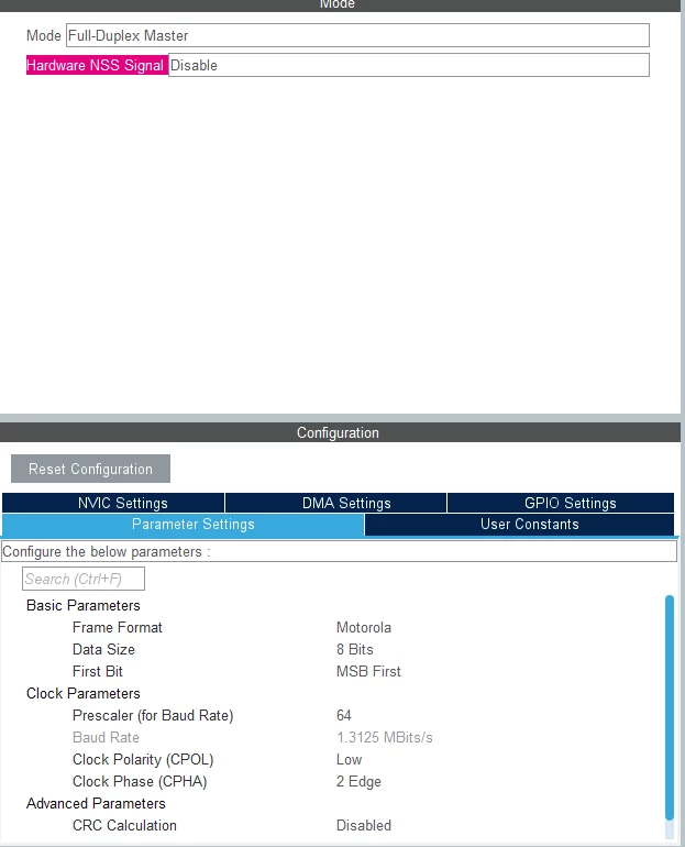

STSM32 SPI configuration:

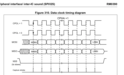

As you can see form above CPOL = 0 and CPHA = 1 (2 edge) this is required for AD5270.

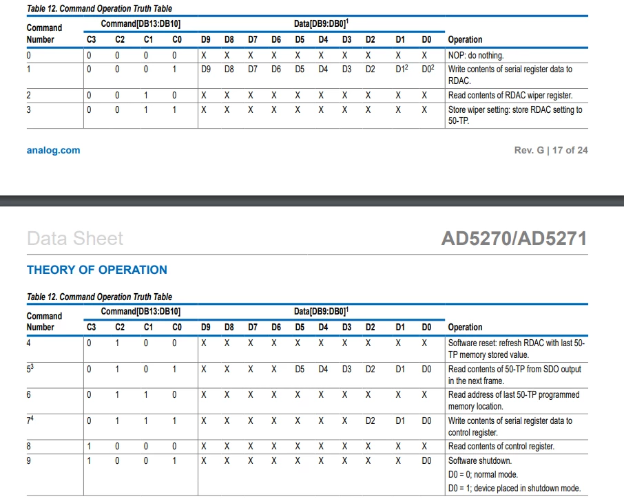

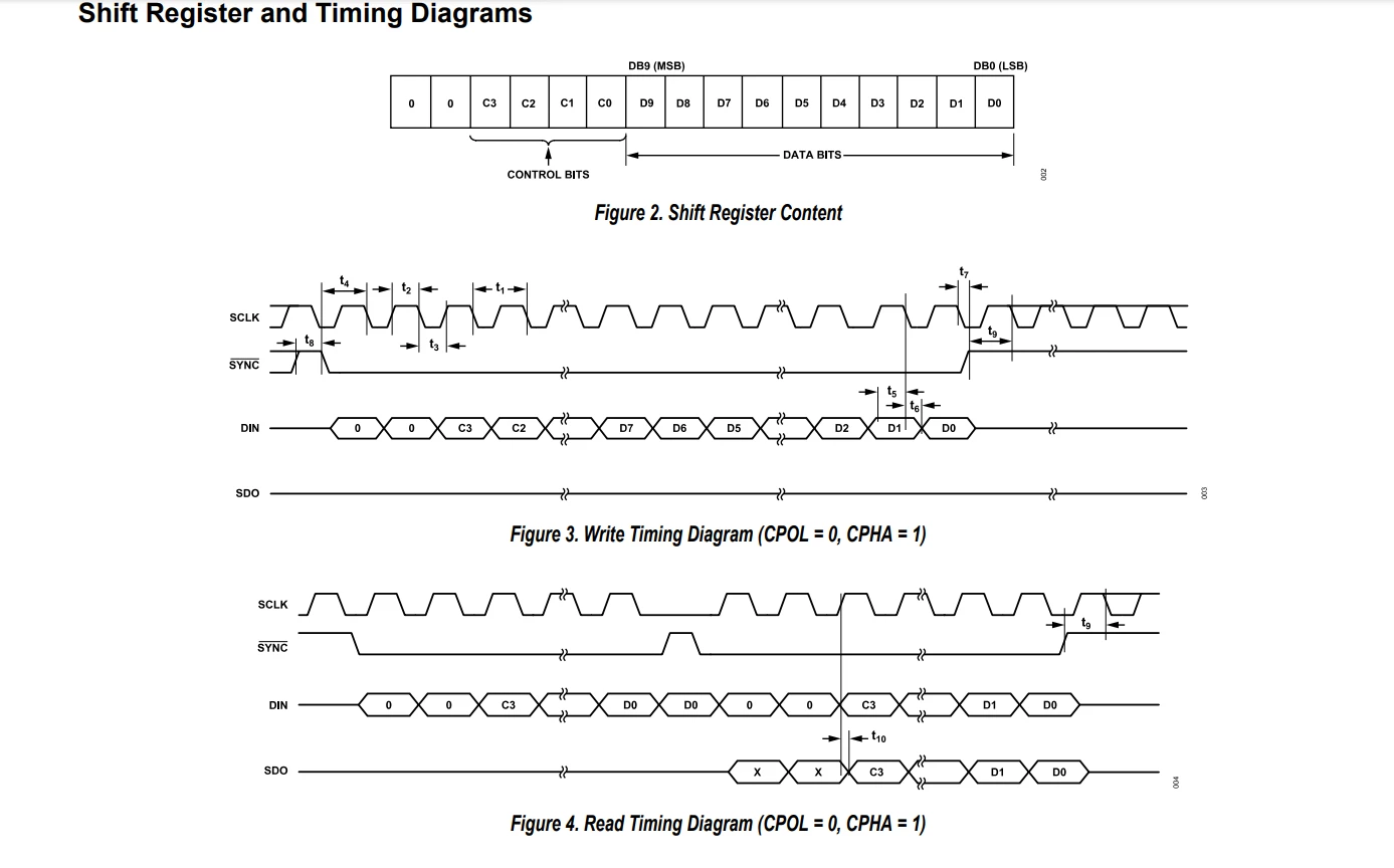

According to AD5270 documentation:
As you can see from the first image, I am mainly interested in Command number 1 (Write contents of serial register data to RDAC)
C3 C2 C1 C0
0 0 0 1
I am now trying to build a correct frame for writing 10 bit value to set the potentiometer value
I am a little confused regarding MSB/LSB. Could someone clarify How do I build correct frame and which order do I need to send bytes. At the moment, I have written this function:

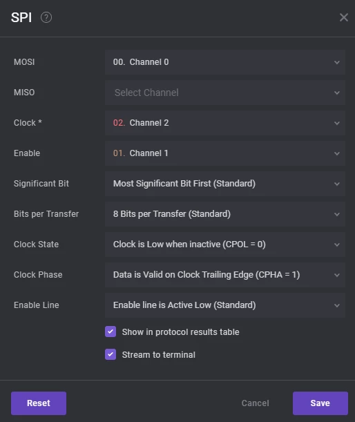

Logic analyzer settings:

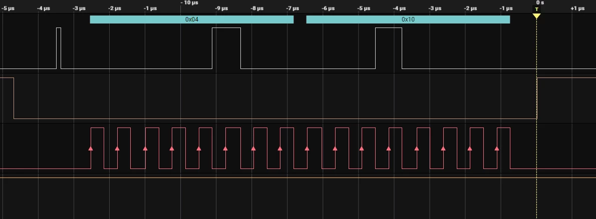

I tried to execute the following command:
AD5270_WRITE_RDAC(16);
 And I see on the logic analyzer:
When I try to send:
AD5270_WRITE_RDAC(2);
The signal looks like:
I just want to understand whether my frame is incorrect or I should be looking at hardware issues (maybe the chip is faulty or something else). I am monitoring Wiper (W pin on the AD5270) using digital multimeter and it does not change when I send the commands. I expect the resistance to change when I write different values to RDAC. The resistance is always set to 900Ohms and its not changing.

CPOL=0 and CPHA=1 means "shift on rising edge, sample on falling".
On the waveforms you've presented it's the other way round.
Read out and check your SPI registers' setting.
