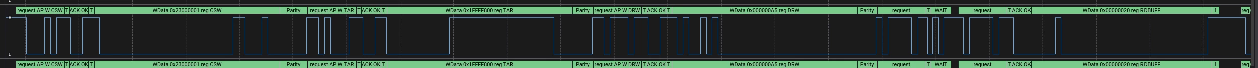

Im developing an program that controls an ST-Link to flash an STM32F1. The program needs to be able to remove RDP on the MCU its trying to flash.
Im doing the following steps:
1) Unlocking Flash - confirmed working (registers confirm)
2) Unlocking option bytes - confirmed working (registers confirm)
3) Erasing Option Bytes - confirmed Working (If I have no RDP on, and erase, RDP gets set, as 0xFF = RDP on)
4) Writing new Option Bytes, 16 Bit Operation. Here it fails.

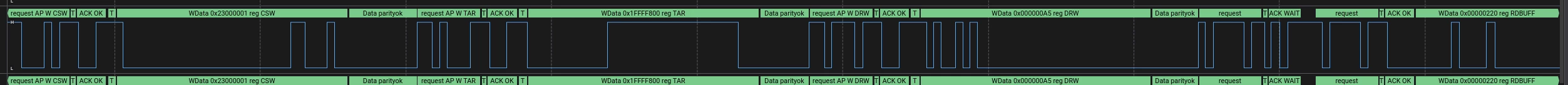

Any Ideas? Ive attached two Logic Analyser captures (Saleae Logic 2 Software), one from slightly modified OpenOCD which unlocks successfully, and my implementation, which doesnt work.
My implementation:
OpenOCD:
Happy to hear your Ideas!

After optiion byte erase, a reset happens. You need to reconnect.
BUt why do you want to write a new stlink program?
guandastAuthor
October 24, 2024
Are they? Kind of hard to believe:
- OPTB is still unlocked after erasing
- If I have an GPIO (LED) high, the LED stays on, even after erase, and only turns off when I do an actual reset
Please correct my if Im wrong.

Thats exactly what Im trying to do, however with OpenOCD as I can browse the source code. My question is, why the Option Byte Write fails, what part I am missing.
jiangfan
October 28, 2024
You need to take care of following point.
The options must be reloaded after every change of the Option bytes in the NVM, so that the
changes can apply.
