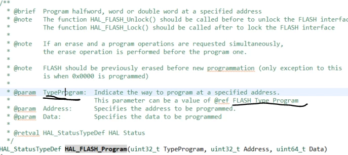

Hi, i am using a stm32f105 but maybe take a look inside your HAL_FLASH_Program() declaration, specifically the FLASH_Type_Program argument.
0693W000008GSnjQAG.pngI only get this options and i believe you should be using FLASH_TYPEPROGRAM_DOUBLEWORD
#define FLASH_TYPEPROGRAM_HALFWORD 0x01U /*!<Program a half-word (16-bit) at a specified address.*/
#define FLASH_TYPEPROGRAM_WORD 0x02U /*!<Program a word (32-bit) at a specified address.*/
#define FLASH_TYPEPROGRAM_DOUBLEWORD 0x03U /*!<Program a double word (64-bit) at a specified address*/
