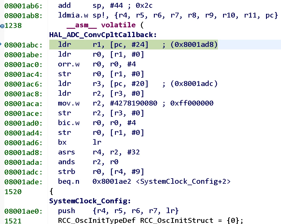

Hello everyone, I am trying to measure how much time is used to finish executing a function. I cannot use the timers because it adds some delay to the system. My other option is to use GPIO pins.
To do this, I
SET a pin at the start of the function
RESET a pin at the end of the function
I then use an oscilloscope to measure the on off time of the pin.
In order to turn on and off the GPIO without too much delay, I have used assembly code to ensure just a few instructions are used for enable and disable the GPIO.
void HAL_ADC_ConvCpltCallback(ADC_HandleTypeDef* hadc)		//called every 4 us.
	__asm__ volatile (
			//turn on GPIO E2
"LDR		R1,		=0x40021014;"
"LDR		R0,	[R1];"
"ORR.W		R0,	#0x0004;"	//only set pin 2
"STR		R0,	[R1];"		//write data to memory
			//write data to data memory
"LDR		R3,		=0xD0007260;"
"LDR		R2,	[R3];"
"LDR 		R2,=0xFF000000;"
"STR		R2,	[R3];"		//write data to memory
			//turn off GPIO E2
//"LDR		R5,		=0x40021014;"
//"LDR		R4,	[R5];"
"AND.W		R0, #0xFFFFFFFB;"	//only clear pin 2
However the generated code looks like the image below...

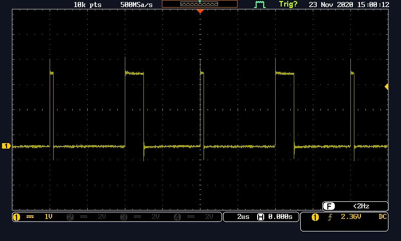

Using this generated code, the GPIO pin to the Oscilloscope produced a pulse with varying width as shown in the image below
0693W000005CEbyQAG.pngFrom my assembly code above, the pulse width should be more or less identical since I am running the same number of instructions each cycle. But I do not know why I cannot get the compiler to follow the assembly code that I wrote in my C program.

EDIT1: Does anyone know why the compiled Assembly code is not the same as my inline assembly code? I would prefer this part of assembly code to not be touched /modified by compiler optimization while still using the optimize for speed option.

    KnarfB
    Nov 23, 2020 7:40 AM UTC
    A lightweight way can be achieved using register level prog. Like:
    LD2_GPIO_Port->BSRR = LD2_Pin;
    HAL_UART_Transmit(&huart2, &ch, 1, 0 );
    LD2_GPIO_Port->BRR = LD2_Pin;
    to switch a LED on before and off after the function call. It translates to efficient assembler code. For switching on:
    ldr r3, [pc, #60] ; (0x8000584 <main+108>)
    mov.w r2, #256 ; 0x100
    str r2, [r3, #24]
    even at -O0 optimization. You may use instruction level debug-stepping to check the generated code (or objdump if you dare).
    ARM thumb2 cannot load general 32-bit constants in one instruction. The constants are stored at the end of the function relative to PC (first instruction).
    The BSRR and BRR registers are used write-only -> no need for a read-modify-write cycles as for ODR register.
    The write value (1<<8) is loaded to r2 in the second instruction. It is finally written in the 3rd instruction.
    Note that r3 holds the base address of the GPIO register block and #24 is the offset of the register within that block. At higher optimization levels, the base address maybe read only once and used many times.
    Don't know why your pulses vary. Maybe caching, instruction folding,... dependig on you MCU (which one?).

    KnarfB
    KnarfBBest answer
    Nov 23, 2020 8:04 AM UTC
    GPIOE->BSRR = GPIO_BSRR_BS_2;
    GPIOE->BRR = GPIO_BSRR_BR_2;
