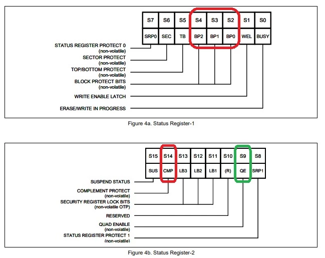

Writing and reading to external NORFlash using QuadSPI on STM32H743 mcu and successfully test erase, write, and read the flash a few days ago but now only read works. What could cause the erase and write command to not fail but not work either?
A few days ago I successfully tested erasing the NORFlash as entire chip erase, block erase, and sector erase. I also was able to write a string to Flash and read the string back out of Flash into a buffer. After working on other development I came back and tested the QSPI again and now I cannot erase or write but can still read out of Flash the test string that was written several days ago. I'm using the exact same code as the first test, trying to just erase and read and get the same string so proved it's not erasing also try to write a different test string and still get the old string when I read. Also during the initial test it would take a little time for a full chip erase and now it just goes through quickly also indicating an erase is not happening. I do have MPU setup for the the 0x90000000 Flash address as well for MPU_PRIVELEDGED_DEFAULT but have access set for ALL_ACCESS so thought this was ok.

I'd recommend clearing the sCommand structure on all occasions, you've got it on most but not all. This will limit odd/unpredictable operation.
Watch also the Status 2 Write, not all generations of Winbond parts support this, and it's hard to determine which you're talking too. Might need to unpack the SFDP (0x5A)

The BPx block protect bits are set in some way, the wrong sequences for Micron, Macronix or Winbond can lock other manufacturer's parts. You'd have to undo that.
Start by dumping out the Status Register(s)
Different Winbond chips support different write status register commands, the older expect SR1 and SR2 to be written as a PAIR, as SR2 can't be written by itself.
Or you've got the chips in the wrong mode, written values in to NON-VOLATILE settings which they subsequently REMEMBER.

I've had a couple of people who've managed to lock out their Winbond W25Q chips, generally BPx or CMP bits get set in SR1/SR2 (non-volatile), and then erase or mass-erase fail quickly as the chip errors if it thinks that includes any protected blocks.

So is there likely something is my driver functions for Erase or Write that would've done this that I need to correct? I'm not sure what to look for.

the code I have was supposed to be for Windbond, but can't be sure

You'll have to read the registers to understand the internal state.
You can't send commands to the device when the STM32 is in Memory Mapped Mode.
