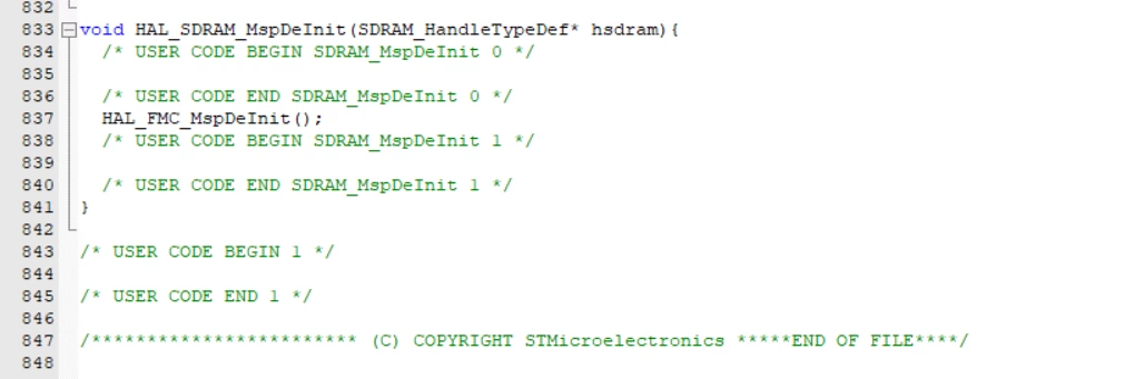

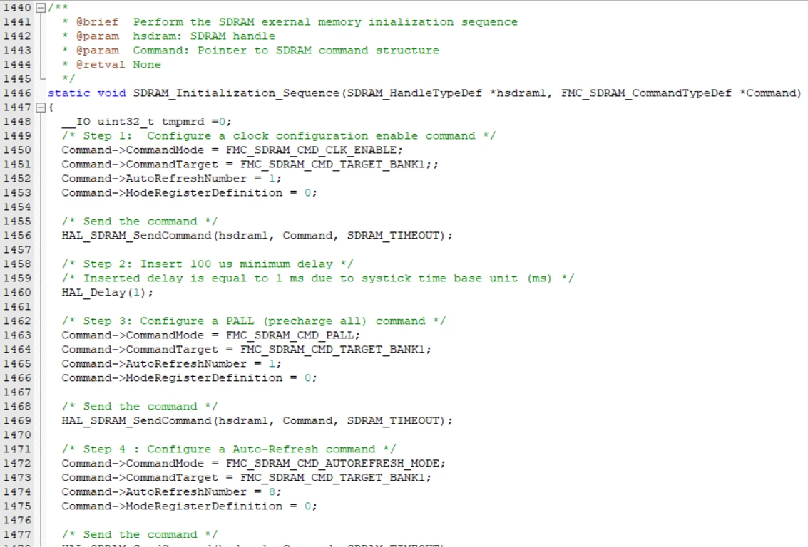

I tried the exemple on the STMH7B3I_EVAL, on my STM32H743 ! But it's not working when i check the adress on SDRAM to see if the data was written or not i find nothing.
I literaly copied the same code from the exemple project of writing and reading with aTxBuffer/aRxBuffer buffers. I checked the Hal_MSP file where the project implements these functions :
-MX_FMC_Init function()
-HAL_SDRAM_MspInit()
-HAL_SDRAM_MspDeInit()
-HAL_FMC_MspInit()
-HAL_FMC_MspDeInit()
Everything seems to be right to me, the configuration of the pins is OK i checked the datasheet of the mcu.
In the main.h i changed the SDRAM_BANK_ADDR  from  ((uint32_t)0xD0000000) to ((uint32_t)0xC0000000) because i dont have the same SDRAM
I attached screens of the integrality of the functions and code of the project !
Thank you in advance for your help !

Sending screenshots of your code is not convenient at all.
Why not from H743 EVAL ?

Hello Mr Mike,
I will send files for the next times its easy to copy past code from files for testing right !
The two FMC exemples are pretty much the same. But i understand why you wanted me to go on the same MCU i'm working with :)
After few changes on the code my application is working now i can write on the SDRAM and read from it what i wrote !
Thank you so much guys @Mike_ST​  @TDK​
