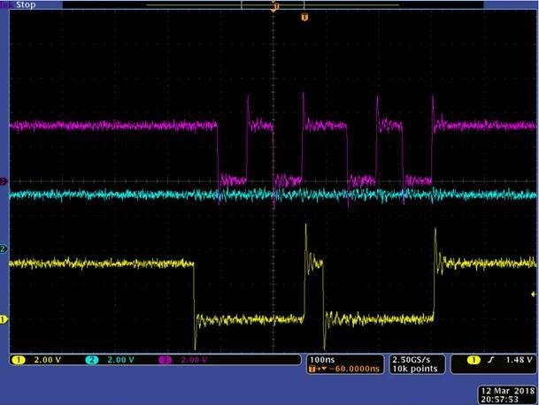

I have the following problem on the micro STM32H743ZIT6:
1) during access to the external write bus, on an SRAM, with only 16 bit bus, occurs when I execute the instruction
* ((uint16_t *) 0x60000000) = (uint16_t) 0xFFFF;
The hardware signals move as follows (/ NE1 yellow, / NOE blue, /WR purple) see attached.
1) It is certainly incorrect because
- /NE1 (yellow chipselect) should only be activated once and not 2.- And / NWR (purple) should only activate 1 within / NE1 and not 2.How come this occurs?
Where am I doing wrong ?
2) The above test was performed with the data cache and code disabled, because otherwise nothing is activated. How can I write externally with the cache enabled?Obviously if it's possible.
