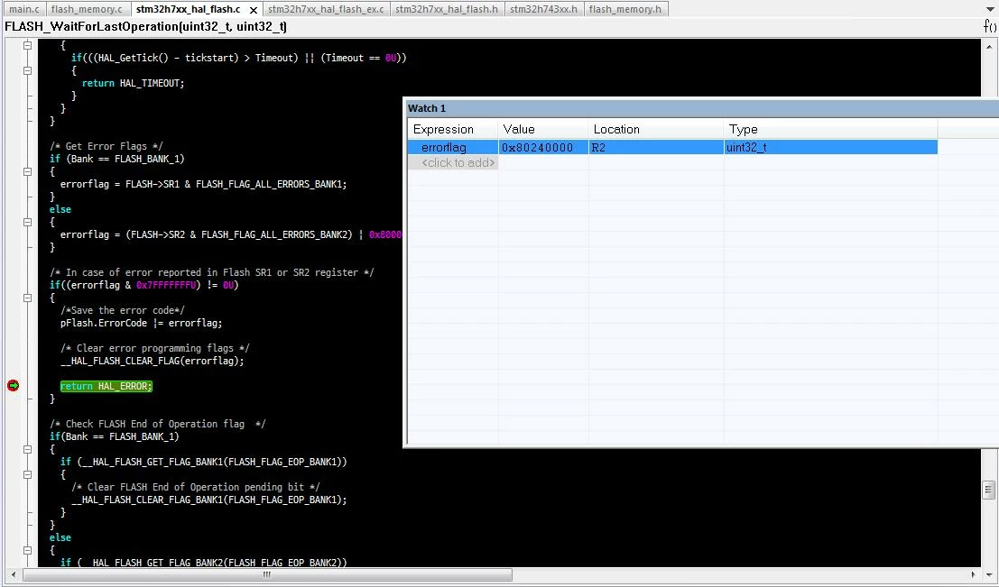

Sometime, It is return HAL_OK. So i can save some data in flash memory.
but Most of them fail to save...​
The error code was return.
Error code is INCERR2: Bank 2 inconsistency error flag and PGSERR2: Bank 2 programming sequence error flag
what is woring?

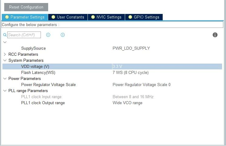

3) My Cubemx Setting
  • Flash Latency(Ws) : 7 WS(8 CPU cycle)

 5) Error Code
  • 0x8024000
