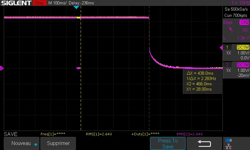

As requested, here more details about the code. The ADC is configured with ADC watchdog and an interrupt is triggered only when a converted value is outside the defined window. This works very well.
Below, the interrupt part.
void ADC5_IRQHandler(void){
	HAL_ADC_IRQHandler(&UVLO::hadc5);
void HAL_ADC_LevelOutOfWindowCallback(ADC_HandleTypeDef *hadc){
	if(hadc->Instance == ADC5)
		HAL_GPIO_WritePin(GPIOE, GPIO_PIN_14, GPIO_PIN_RESET);
		Interrupt::UVLO_ADC_Watchdog_ISR(); //will call the function shown in the first post
		HAL_GPIO_WritePin(GPIOE, GPIO_PIN_14, GPIO_PIN_SET);
My project is in C++, so there are some stuff to retrieve the initial context from the interrupt, but I finally call the function Config::writeFlash()
I used the GPIO to measure the elapsed time to write in Flash. It is pretty quick. I have much time left before BOR.
(yellow : VDD, purple: the GPIO voltage)
I have tried in two different way, with same issue :
  • write in flash from the ISR
  • Set a flag in the ISR and write in Flash from main loop
In both case, only 0x0 are written in Flash at the specified address
