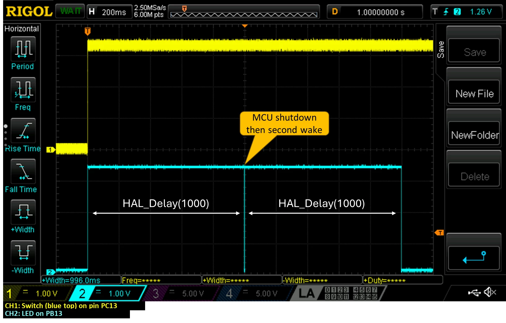

WKUP pin wakes MCU twice but it should only wake once ?

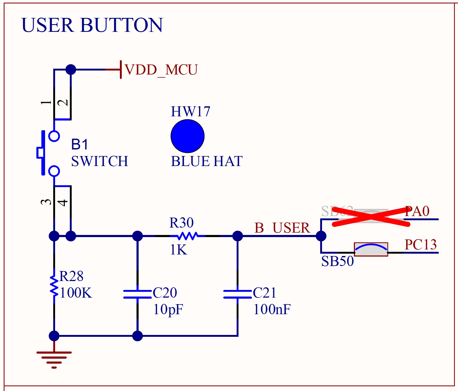

I am using the NUCLEO-L433RC-P with the blue top switch (pin PC13) configured as a wake pin.

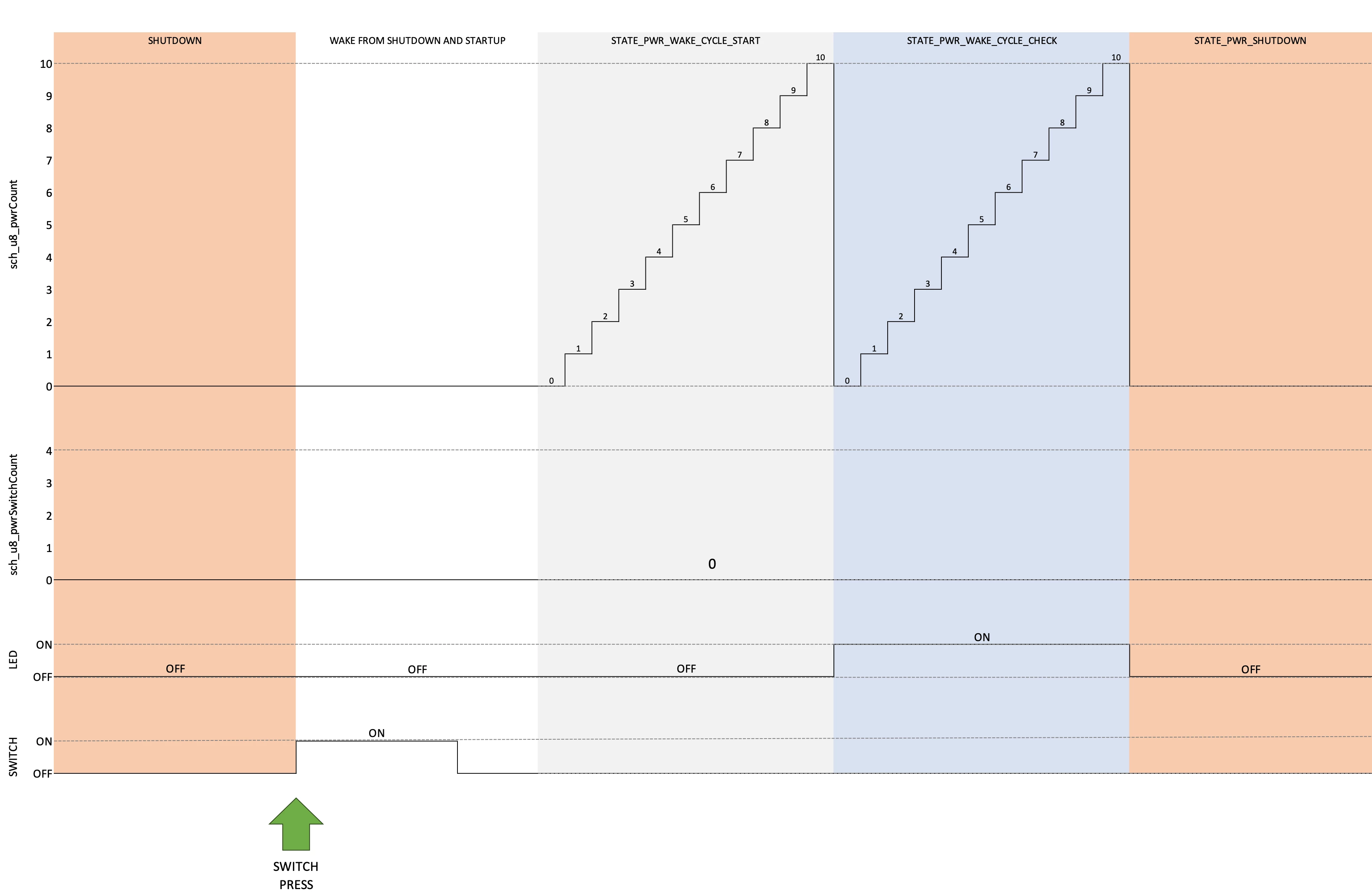

When the switch is pressed, the MCU should wake, then turn the LED on, then shutdown.

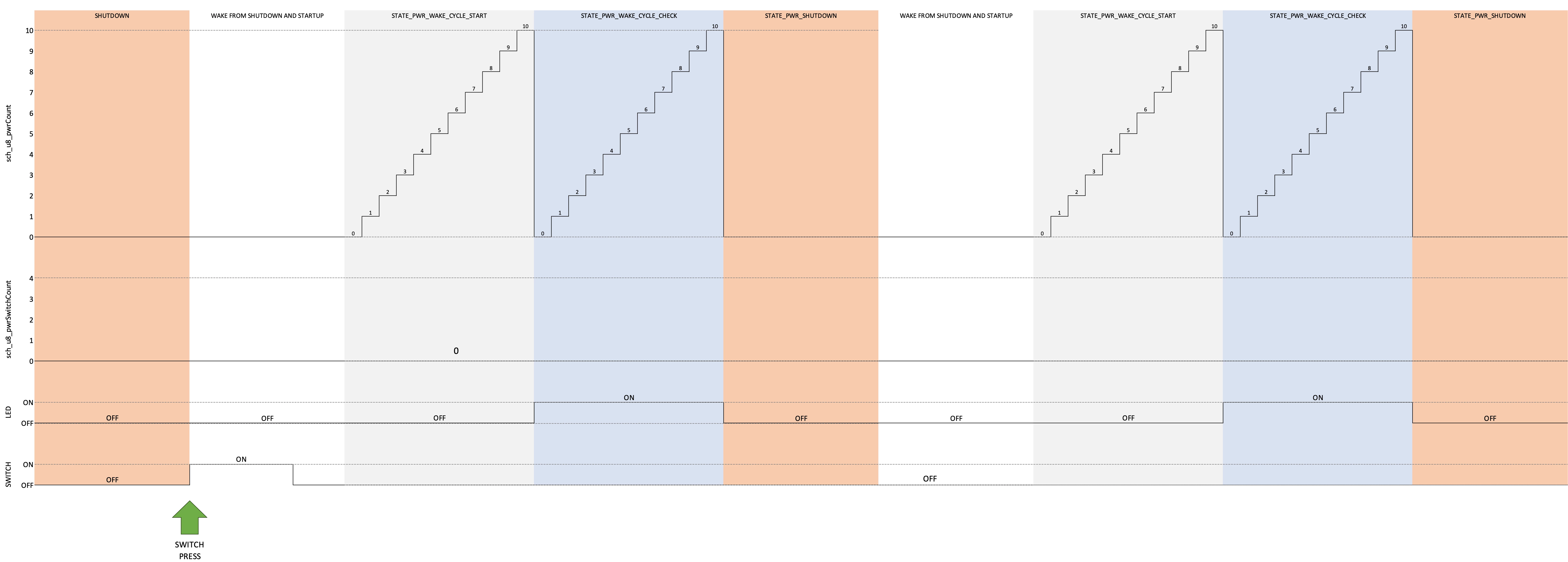

But for some reason the MCU wakes twice as observed by the following behaviour:
  1. Switch pressed
  2. MCU wakes (LED turns on)
  3. MCU shuts down (LED turns off)
  4. MCU wakes again (LED turns on)
  5. LED finally shuts down (LED turns off)
This happens even though the switch is only pressed once.
The switch has RC filters so its not a debounce issue, especially as it happens even if the switch is held down.
My function Enable_PC13_Wakeup() clears flags etc before shutdown, so I don't understand why the MCU is waking twice.

Below are diagrams of the state machine (running in a 100ms task) after the switch has intially been pressed and woken the MCU from shutdown.  This is how the functionality should work.
The following diagram shows an invalid power up request.  When the LED is on, the switch is not pressed to 'extinguish' the LED and when the counter (sch_u8_pwrCount) reaches 10 the state machine goes into the shutdown state where it calls the shutdown function.
The following diagram shows a valid power up request.  Each time the LED is on, the switch is pressed to 'extinguish' the LED before the counter (sch_u8_pwrCount) reaches 10.  When the counter (sch_u8_pwrSwitchCount) reaches 4, the state machine goes into the running state.

But the fact is that the MCU wakes twice from shutdown when the button is pressed (this is not shown in the figures).
I confirmed that the MCU is waking from shutdown twice by setting a breakpoint at the beginning of the program (HAL_Init) which is hit twice and also by setting a GPIO pin and monitoring it on a scope.
The figure below shows what is actually happening...

Strangely... and I don't know whether this might be a clue... when debugging there is only one wake cycle.  The issue with 2 wake cycles only happens when not debugging i.e. in standalone
It also only happens when the switch is held down, not if the switch is pressed then released.
Below is the scope trace showing the switch (channel 1 yellow) and LED (channel 2 cyan).
With the switch permanently pressed, you can clearly see that after 1000ms that the LED turns off.  But then it turns back on again for another 1000ms (the second wake cycle which should not have happened).  After that the LED remains off.
The simplified software is below...

	HAL_GPIO_WritePin(STATUS_LED_GPIO_Port, STATUS_LED_Pin,GPIO_PIN_SET); 		// turn LED on
	HAL_Delay(1000);
	SCH_mcuShutdown();
