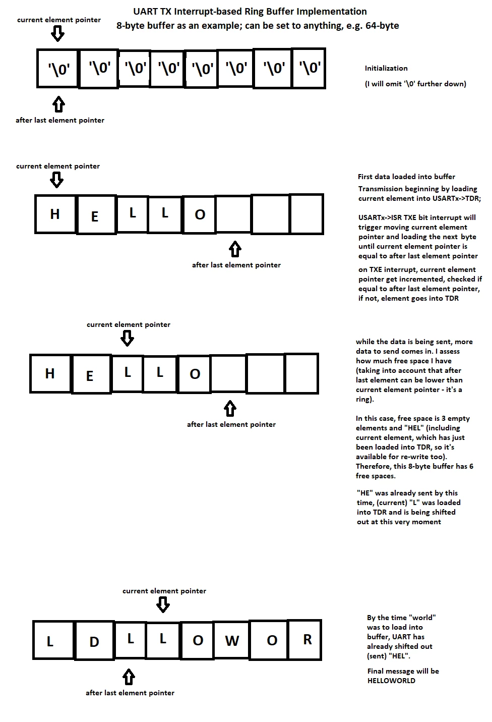

Will USART send a TXE interrupt to NVIC if TXEIE is enabled AFTER TXE became set?
STM32F746-Disco board; Windows 10, STM32CubeIDE 1.7.0, empty project, only CMSIS and nothing else.
I'm writing an interrupt-based UART transmit driver with ring buffer on registers for the sake of learning (no DMA, that will come later, after I grow some IQ). Reading datasheet, reference manual and programming manual (for NVIC), I think I understand the stuff. The driver is not test-ready yet, it's work in progress, although the setup is done. I want to make sure I understand the stuff correctly.
To the point:
See the picture attached, top notch paint skills to explain how my uart tx ring buffer works.
In written form: I have an array that I use as a ring buffer for transmission. There is a pointer to the element that is currently being sent and the "after last element" pointer. When I reach the last element of array, I move to the beginning of the array. Hence, ring buffer.
Now, imagine I'm already sending something. At that moment I have another send request. What I do is I check how much free space my ring buffer has (buffer size minus how many chars are still waiting to be sent), and if it fits, it sits I write that new data into the buffer and move after last pointer accordingly. Basically, append it to what's already waiting to be sent.
However, it got me thinking. Since I have a whole UART frame to load the next byte into send register (Transmit Data Register, USART1->TDR) before Transmission Complete flag is set, I thought I could disable UART interrupts (transmit, more specifically TXE) while I load new data into buffer ring array. But I still want them to become "pending" so that when I reactivate interrupts after the data is loaded into buffer, the program will see those interrupts happened and deal with them (so if I need 1 UART bit of time to copy the data into buffer, on bit 2 the MCU will load the next byte into USART1->TDR).

As promised, here is my crude visual representation of what I'm doing. Not really that important for the question, but still.

Also, if you're in the mood, feel free to criticize my algorithm, always open to feedback, especially given I'm a developer larva.
