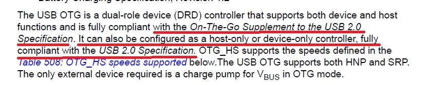

This this what the reference manual is telling / chapter 57 USB on-the-go high-speed (OTG_HS):

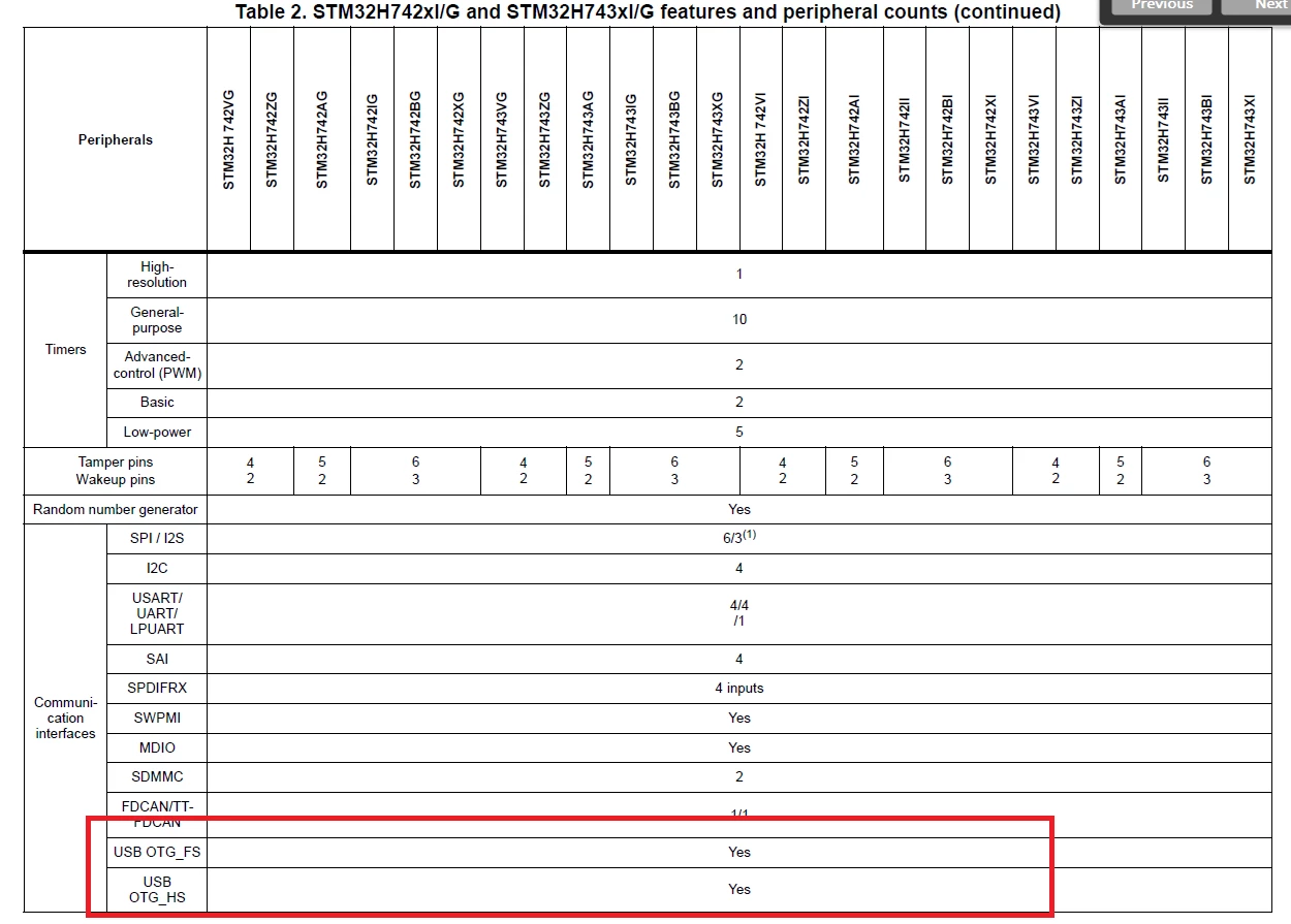

STM32H743 supports USB High speed and Full speed:
What do you mean by normal USB operations? USB 2.0 or what?

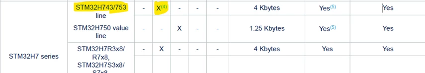

MeghnaAuthor
May 20, 2025
It shows that STM32H743BIT6 supports only FS operations, why?
mƎALLEm
May 20, 2025
You need to provide the document from which you captured that screenshot.
