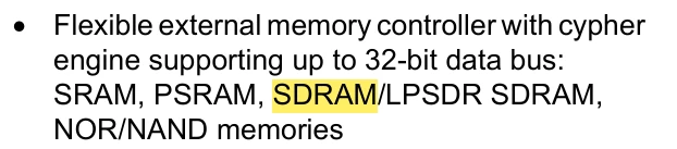

> The STM32MP657 has a DDR3/LPDDR2/LPDDR3 memory controller. The W9825G6KH-6 is an SDR SDRAM. These are two completely different, incompatible memory technologies.
STM32N657 definitely support SDRAM. It can work with the W9825G6KH-6 in SDR mode.
