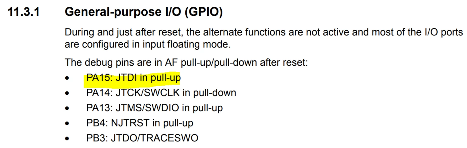

PA15 is configured with a pullup after reset as it's a JTAG pin.
ambrose
ambroseAuthor
February 9, 2022
Hi, thanks a million for the response. this is true, but my issue occurs after the application has been running for a while. It actually forces the pin low.
