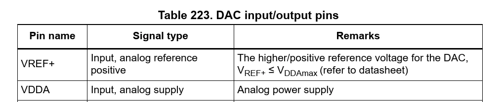

Do you know where I can find the DAC's internal reference voltage? I can't seem to find its reference voltage from the electrical schematics. Could it perhaps be in the configuration setting?

After looking at the schematics again I find VDDA and VREF+ are both connected to a 3.3V source. So why is the max output voltage for the DAC stuck at 2.56V?
Does it have something to do with pin PB1?

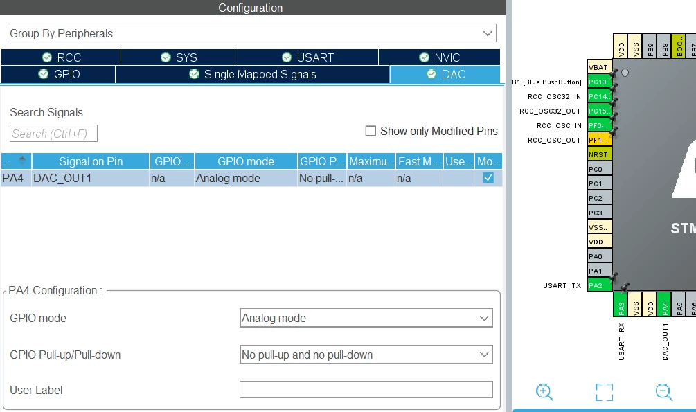

RWang.9
RWang.9Author
May 29, 2023
The DAC output is connected to the PA4 pin and is set to analog.
_legacyfs_online_stmicro_images_0693W00000bl4L0QAI.pngDo you have any recommended content on GPIOA registers?
RWang.9
RWang.9Author
May 29, 2023
The DAC output is connected to the PA4 pin and the pin is in Analog mode.
_legacyfs_online_stmicro_images_0693W00000bl4MXQAY.pngDo you have any recommended content about GPIOA registers for me to read about?
