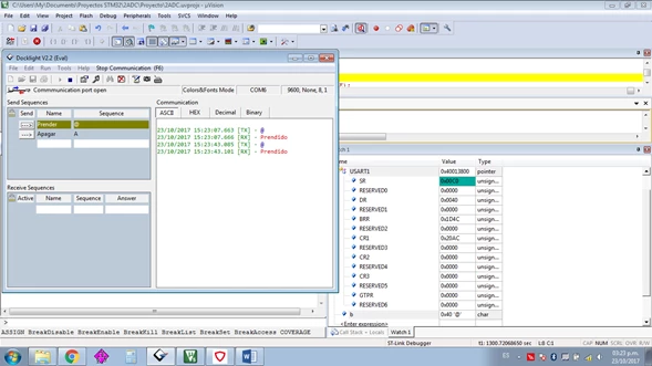

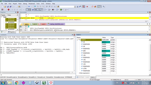

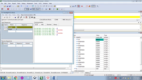

    Well, I have some images to share, I hope they be useful to know more about this issue.
    In the first image I use the debug session to know the status of the USART1, as you can see in the DR register there's a 0.
    The second image show's how after we send a data trough the serial port, the DR register changes and the ''char'' variable ''b'' changes from 0 to ''0x40 '@'. In this case the led connected to the board turns on and returns a message of ''Prendido'' (Turn On). At this point everything's all right.

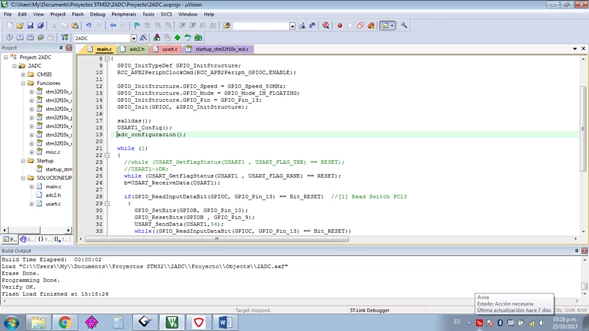

    The third image shows how I add the function adc_configuracion, to start the two ADC converters and as I say, the char variable ''b'' is used to receive the data from the serial port. I used the instruction that
    Turvey.Clive.002
    ‌ recommended to know if the USART->DR is in conditions of receive or send data.(also y fixed the &error in the adc configuraton, thank you!!)
    In the last image I show how the DR register receives the data (0x40) but the variable ''b'' doesn't changes the status and the led doesn't turn on, the word ''Prendido'' do not appear in the screen as well.
    Is in this moment when the ''interrupt runtimes'' (that
    meyer.frank
    ‌ has commented to verify), are in conflict?? Because it seems that after to receive the data in the register, this information doesn't arives to the USART bus, or why this would occur: The variable ''b'' do not receive the information from the USART.
    Thank you very much!!
    AvaTar
    Senior III
    October 24, 2017
    Posted on October 24, 2017 at 10:25
    I don't see any UART receive code, and and no interrupt handler.
    Perhaps you are polling UART1->RX, and don't use interrupts ?
    With busy-looping while UART transmissions (like this):
    for ( ; *s; s++)
         USART_SendData(USARTx,*s);
        while( USART_GetFlagStatus(USARTx, USART_FLAG_TC) == RESET );
    you will surely have trouble to fetch received chars in time.
    One missed char sets the OV flag, and stops reception until you explicitly reset the flag.
