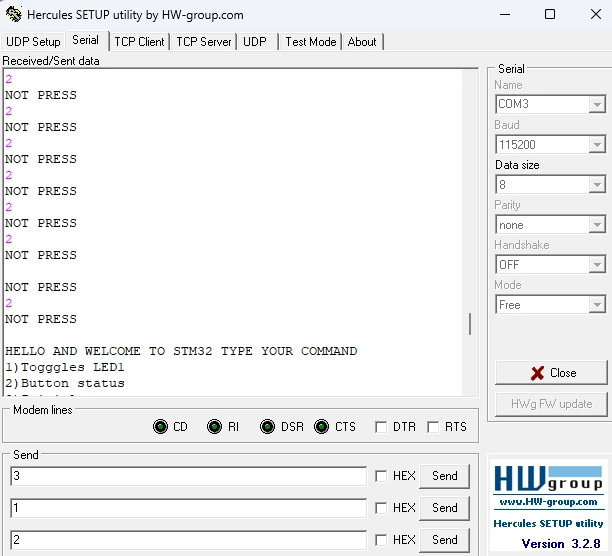

Why UART sometimes print twice the message?

The code is working, but I don't understand why sometimes the serial terminal show me twice.
Because you're in a tight loop, and send things based on a flag you don't clear immediately.

Sorry I am new in stm32 programming. I think that too but I've add in the Uart callback functions some lines that clear the flags(rx_flag and tx_flag). If I've understand correctly after the transmissions of the data, first the callback function is execute, and then the infinity loop starts again. Is this correct?
Tesla DeLorean
Guru
November 28, 2022
while(1)
 if(tx_flag == 1 && rx_flag == 0){
 HAL_UART_Transmit_IT(&huart2,(uint8_t*)tx_message,sizeof(tx_message)); // Called repetitively, returns immediately
while(1)
 tx_flag = 2; // stop repeatedly transmitting, clear in call back on COMPLETION
 HAL_UART_Transmit_IT(&huart2,(uint8_t*)tx_message,sizeof(tx_message)); // Returns immediately
Stuff in the foreground is running continuously. The callbacks occur after something completes, not immediate before it starts.
RX likely needs some work on the logic too.

Thank you for your code! But it's not clear to me why in my code I am not cleaning the flag. I try to explain. When I enter in the loop for the transmission, first it start the HAL_TRASMIT_IT(), after this instruction then the interrupt start and there the flag are cleared. Why is it not correct?
Karl Yamashita
Principal
November 29, 2022
It was already explained by @Community member​ by his code that i'm quoting below.
You need to clear your tx_flag or change it to something other than 1 once you test for it and before you start HAL_UART_Transmit_IT. However if the HAL status returns HAL_BUSY then whatever you're trying to transmit will fail so that is why you need to act upon the HAL status. What I posted will work but I should have added my ring buffer code because the tx_message can be overwritten by new data if you receive some new data before the transmit finishes.
while(1)
