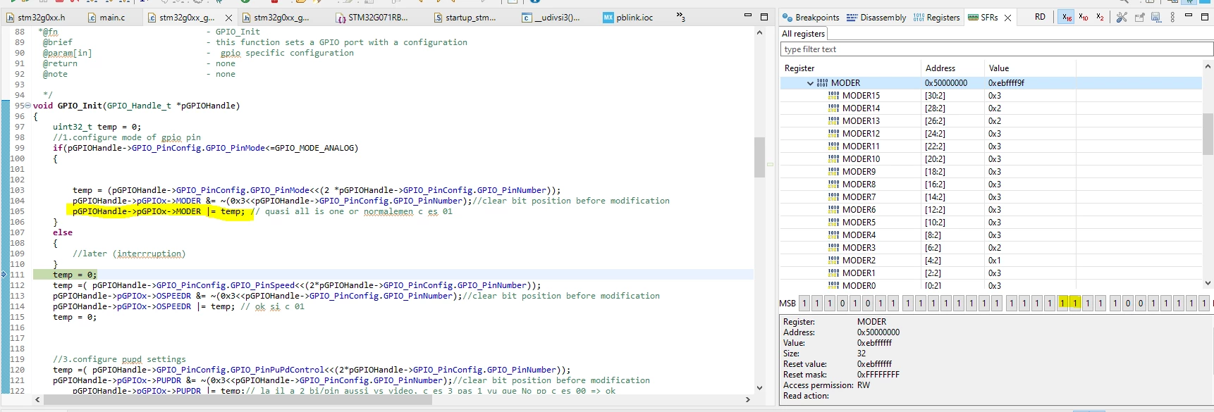

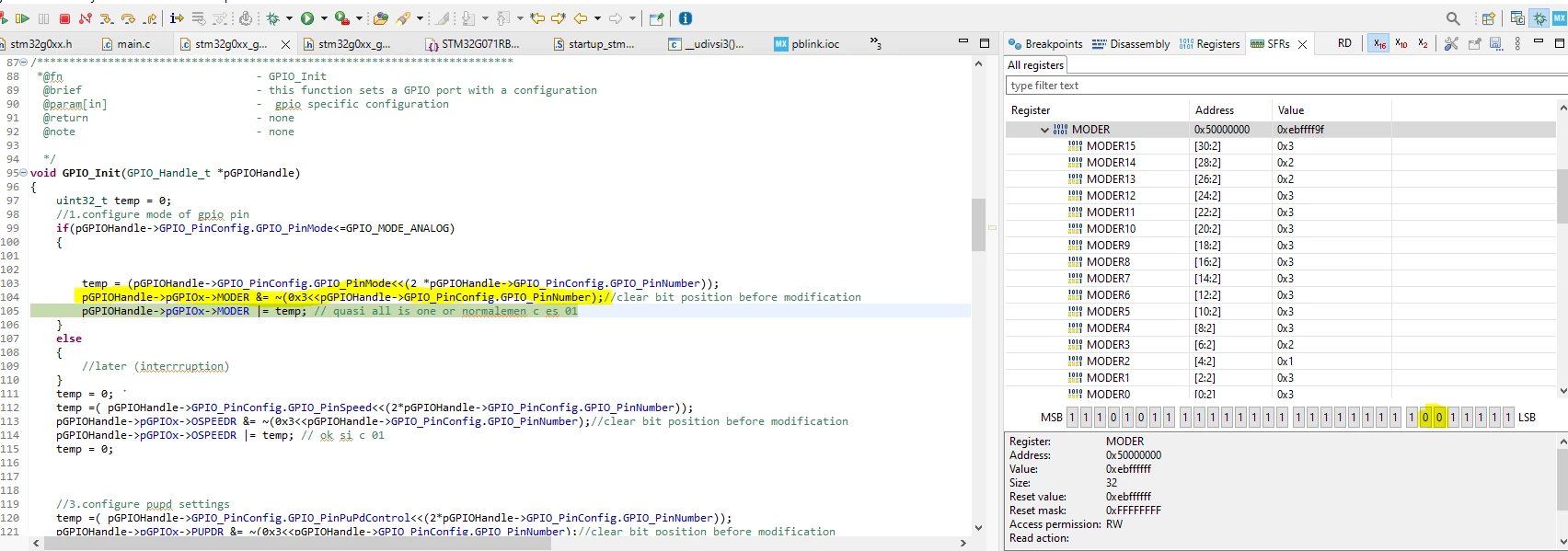

Why toggling LED4 USER doesn't work with this code ( Board nucleo G071RB) ? I know that problem is in my init function. But I don't know how to correct it because GPIOA base adress (which is also MODER register address) is right

void GPIO_Init(GPIO_Handle_t *pGPIOHandle)
	uint32_t temp = 0;
	//1.configure mode of gpio pin
	if(pGPIOHandle->GPIO_PinConfig.GPIO_PinMode<=GPIO_MODE_ANALOG)
		temp = (pGPIOHandle->GPIO_PinConfig.GPIO_PinMode<<(2 *pGPIOHandle->GPIO_PinConfig.GPIO_PinNumber));
		pGPIOHandle->pGPIOx->MODER &= ~(0x3<<pGPIOHandle->GPIO_PinConfig.GPIO_PinNumber);//clear bit position before modification
		pGPIOHandle->pGPIOx->MODER |= temp;
	else
		//later (interrruption)
	temp = 0;
	temp =( pGPIOHandle->GPIO_PinConfig.GPIO_PinSpeed<<(2*pGPIOHandle->GPIO_PinConfig.GPIO_PinNumber));
	pGPIOHandle->pGPIOx->OSPEEDR &= ~(0x3<<pGPIOHandle->GPIO_PinConfig.GPIO_PinNumber);//clear bit position before modification
	pGPIOHandle->pGPIOx->OSPEEDR |= temp;
	temp = 0;
	//3.configure pupd settings
	temp =( pGPIOHandle->GPIO_PinConfig.GPIO_PinPuPdControl<<(2*pGPIOHandle->GPIO_PinConfig.GPIO_PinNumber));
	pGPIOHandle->pGPIOx->PUPDR &= ~(0x3<<pGPIOHandle->GPIO_PinConfig.GPIO_PinNumber);//clear bit position before modification
		pGPIOHandle->pGPIOx->PUPDR |= temp;
		temp = 0;
	//4.configure output type
		temp =( pGPIOHandle->GPIO_PinConfig.GPIO_PinOPType<<(1*pGPIOHandle->GPIO_PinConfig.GPIO_PinNumber));
				pGPIOHandle->pGPIOx->OTYPER |= temp;
				temp = 0;
	//5.configure the alt functionality
	if(pGPIOHandle->GPIO_PinConfig.GPIO_PinMode == GPIO_MODE_ALTFN)
		uint32_t temp1, temp2;
		temp1= pGPIOHandle->GPIO_PinConfig.GPIO_PinNumber/8;
		temp2= pGPIOHandle->GPIO_PinConfig.GPIO_PinNumber%8;
		pGPIOHandle->pGPIOx->AFR[temp1] &= ~(0xF<<(4*temp2));//clearing
		pGPIOHandle->pGPIOx->AFR[temp1] |= (pGPIOHandle->GPIO_PinConfig.GPIO_PinAltFunMode<<(4*temp2));

image00 : When I try to clear GPIOA MODER register bits, only these one are setted with 0.0693W00000Y93XqQAJ.pngimage01:the bits corresponding to pin number 5 are not setted with the correct values. (It should be 01)

    I would like give som update before closing the subject. I have made few mistakes in my code. First of all in
    void GPIO_Init
    was not right. I had to write :
    pGPIOHandle->pGPIOx->MODER &= ~(0x3<<(pGPIOHandle->GPIO_PinConfig.GPIO_PinNumber*2));
    and in my main()
    I had forgotten
    GpioLed.GPIO_PinConfig.GPIO_PinMode =GPIO_MODE_OUT;
