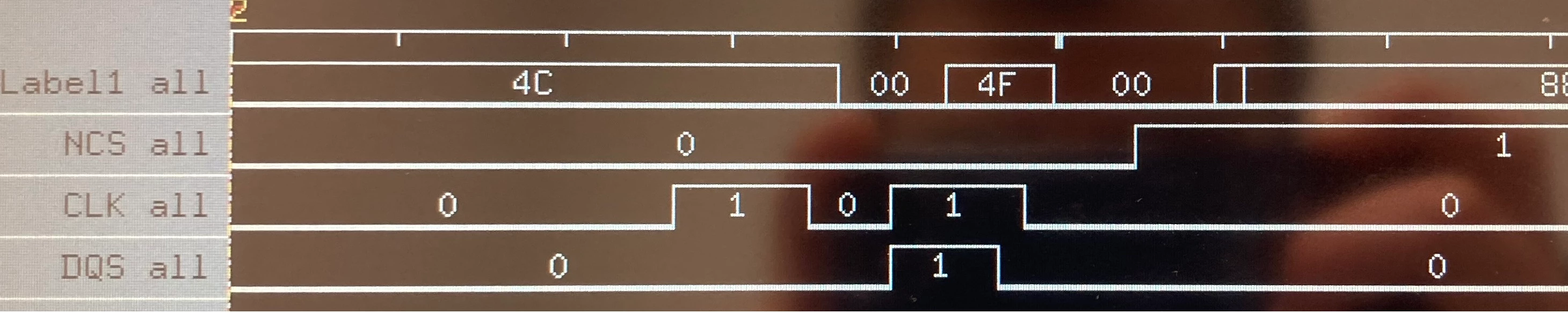

My purpose is to send an "HELLO" using a NUCLEO-L4R5ZI-P board trough HYPERBUS.
On the STM32CubeIDE, I configurated OCTOSPI1 peripherial and I/O associated.
/* USER CODE END Header */
#include "main.h"
#include "octospi.h"
#include "gpio.h"
/* USER CODE END Includes */
/* USER CODE BEGIN PTD */
/* USER CODE END PTD */
/* USER CODE BEGIN PD */
/* USER CODE END PD */
/* USER CODE BEGIN PM */
OSPI_HyperbusCmdTypeDef scommand;
/* USER CODE END PM */
/* USER CODE BEGIN PV */
uint8_t buffer[] = "HELLO";
/* USER CODE END PV */
/* USER CODE BEGIN PFP */
/* USER CODE END PFP */
/* USER CODE BEGIN 0 */
/* USER CODE END 0 */
int main(void)
 /* USER CODE BEGIN 1 */
 /* USER CODE END 1 */
 HAL_Init();
 /* USER CODE BEGIN Init */
 /* USER CODE END Init */
 SystemClock_Config();
 /* USER CODE BEGIN SysInit */
 HAL_OSPI_MspInit(&hospi1);
 /* USER CODE END SysInit */
 MX_GPIO_Init();
 MX_OCTOSPI1_Init();
 /* USER CODE BEGIN 2 */
 scommand.AddressSpace = HAL_OSPI_MEMORY_ADDRESS_SPACE ;
 scommand.AddressSize = HAL_OSPI_ADDRESS_16_BITS;
 scommand.DQSMode = HAL_OSPI_DQS_ENABLE;
 scommand.Address = OCTOSPI1_BASE + 5;
 scommand.NbData = 5;
 /* USER CODE END 2 */
 /* Infinite loop */
 /* USER CODE BEGIN WHILE */
 while (1)
	 HAL_OSPI_HyperbusCmd(&hospi1,&scommand,HAL_OSPI_TIMEOUT_DEFAULT_VALUE);
	 HAL_OSPI_Transmit(&hospi1,buffer,HAL_OSPI_TIMEOUT_DEFAULT_VALUE);
	 HAL_Delay(1);
	 //uint8_t* mem_addr = ( uint8_t * )( OCTOSPI1_BASE + 0 );
 /* USER CODE END WHILE */
 /* USER CODE BEGIN 3 */
 /* USER CODE END 3 */

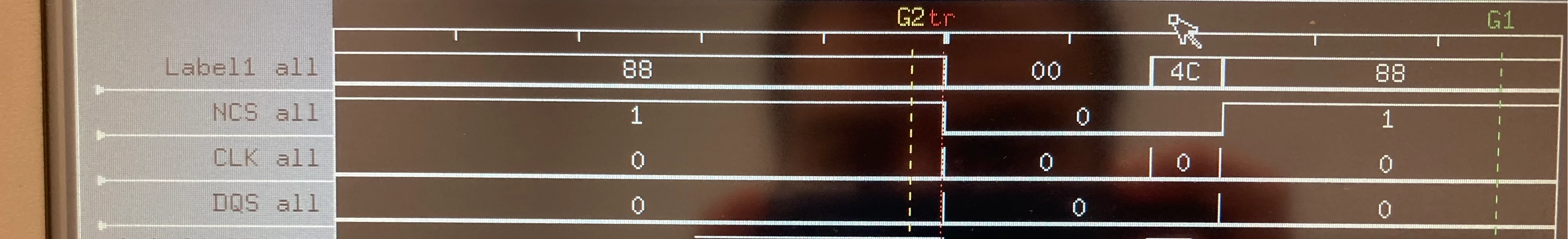

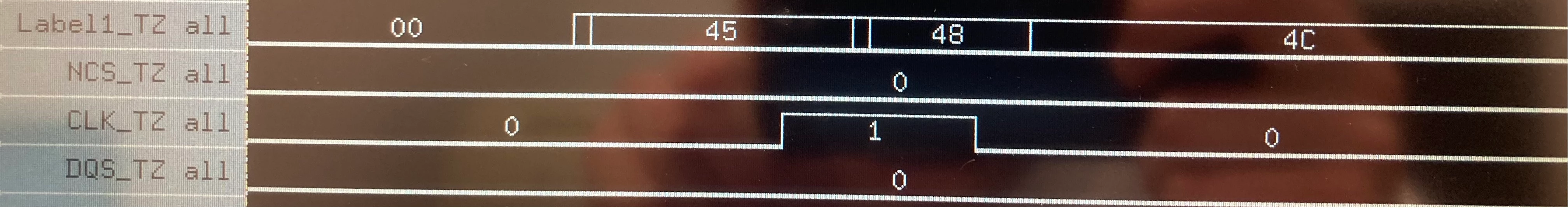

But when I'm debugging this program with a logic analyser I have frame that doesn't look like an Hyperbus frame.
I have 2 bytes sent then a long gap before the 3 next bytes are sent.
Also the data strobe rise on last byte sent when it should rise on each data.
0693W00000BZsUxQAL.jpg0693W00000BZsVWQA1.jpgHow can I solve this?
