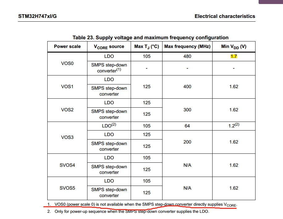

Why STM32H745xxx can't run at 480Mhz when the core is supplied by internal SMPS directly?
  • April 8, 2020
  • 1 reply
  • 881 views

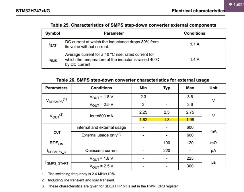

The SMPS output voltage can reach 1.8V . That is upper than 1.7V requested.
1 reply
JieHong Mai
April 30, 2020
I know that.
Because the volatage for the core actual needed is 1.38V. The internal SMPS output voltage is too big.
It will make IC more heater.
As to,why internal LDO can run at 480Mhz, in my opinion, it is that the LDO area of the chip can bear higher temperature.
