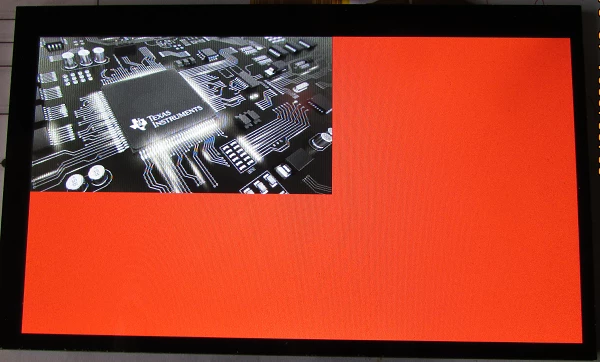

I followed the example in article AN4861 where STM explains how to setup RGB565
all is working fine but when I switch to RGB888 I get only white and black

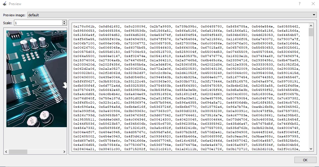

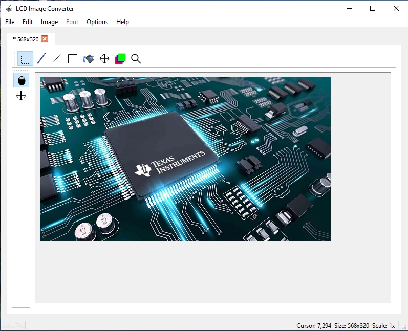

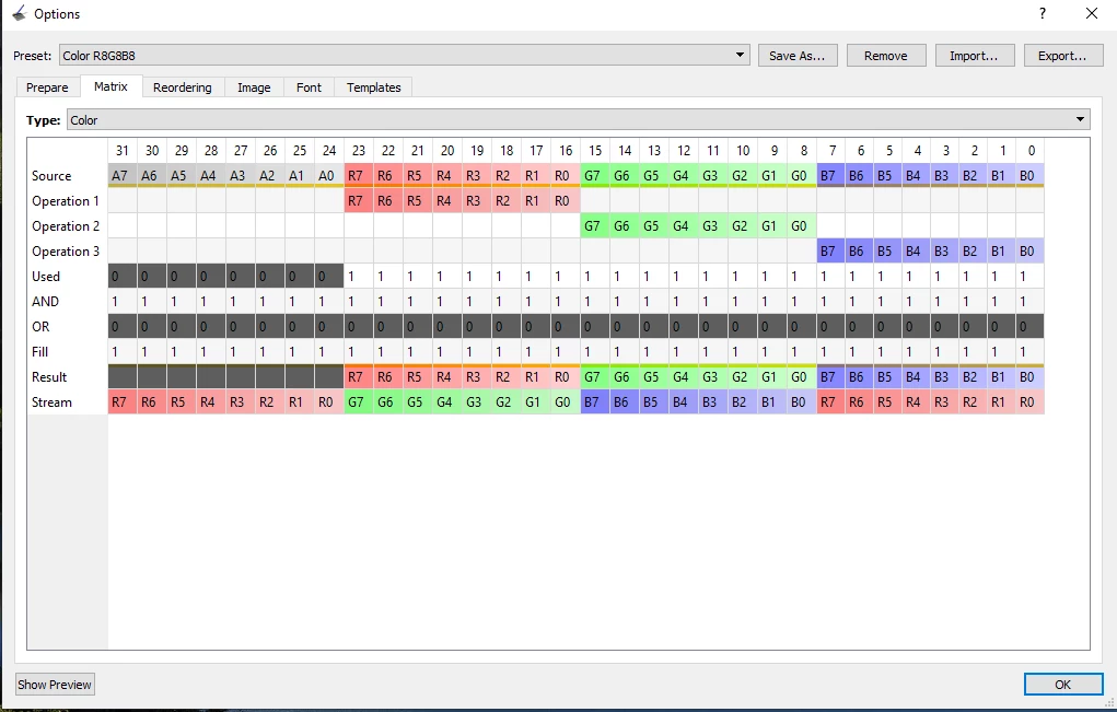

I use the image converter LCD-Image-Converter-20161012 tool explained in the article
the preview show color picture like all is setup right but still I get black and white

Old RGB565 image wouldn't display, it would be distorted. So it wouldn't look like on the first picture. If you were familiar with RGB display this is something you would know.

Try show part of image src file generated ...
